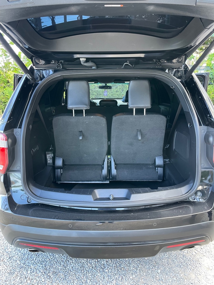

The final issue is with the third row: they don’t move or do anything when activated through the switches.

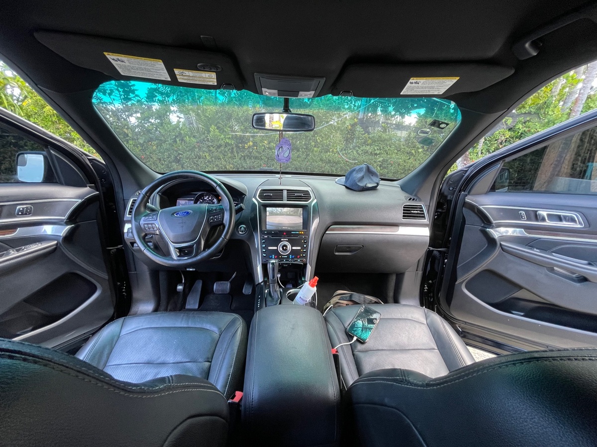

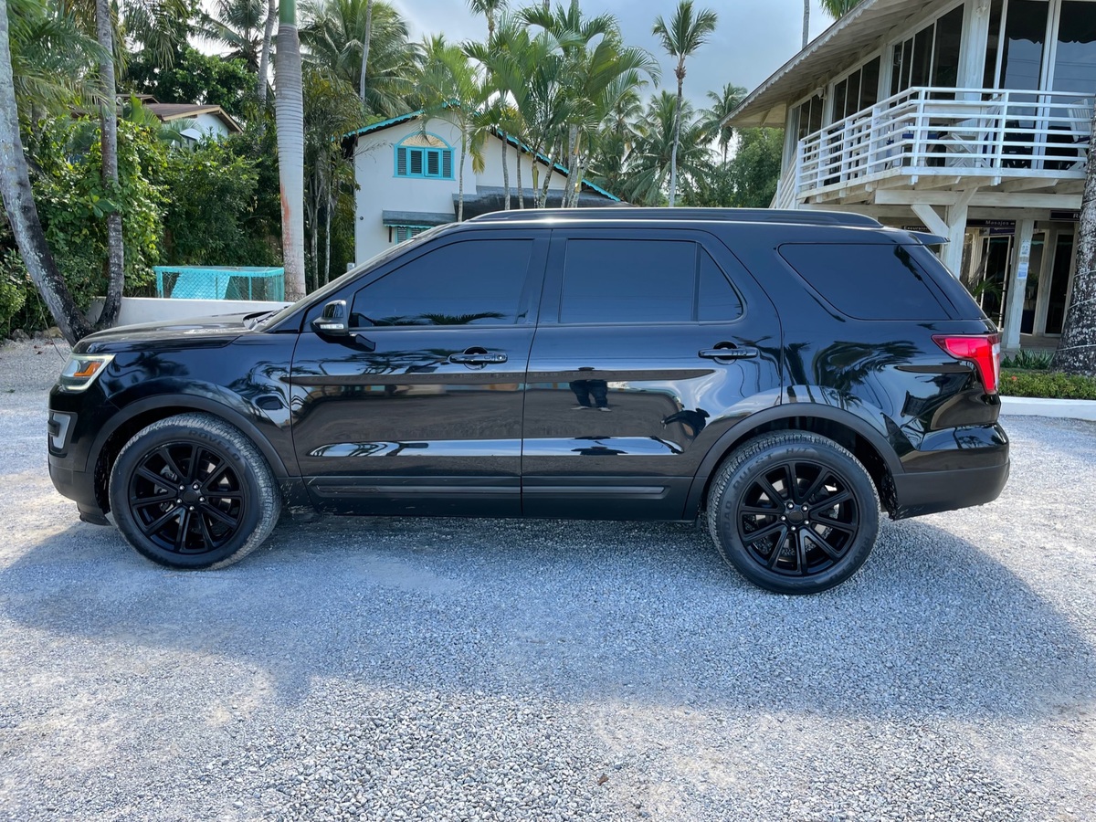

Here are some pics!
Welcome to the Forum. :wave:
One of the other important items on a PIU in addition to mileage is the number of 'idle hours'.
The pictures you posted do not look like the interior of a PIU. Most, if not all PIU have a column shifter instead of a console shifter. What I really wanted to see was what kind of badging is on the liftgate. It also does not have the typical PIU grille or wheels. Perhaps it was a supervisor's vehicle? :dunno:
First, check your VIN. "K8A" is the body code for an Interceptor. If that isn't in the VIN, it's not a PI.
Does IDS say the BCM/computer is from a PI or does your VIN reflect this? What engine does your rig have?
Let me say...great looking rig! But, there is a lot on it that isn't Interceptor. Yes, all PI come with column shift. Besides the interior, larger screen, third row seat, third row seat belts, and floor shifter....it has a roof rack, engine cover..etc. Even the exhaust tip are not what come on a PI. (I have a '16 PI and can send photos if you want to see the difference) Thinking out loud, there is structural frame work built into the rear of the PI to get it's 75MPH crash rating..that I don't believe can co-habitate with a third row seat. Regardless, it should be visible to tell. PIs also have an engine hours, and idle hours meter in the left display.

Thank you very much! We’ve managed to make the push start work as normal, along with the keyless entry. Also, the third row now folds and does everything it’s supposed to. The hill descent is enabled as well, with all modes of terrain activating as one scrolls through the central console wheel. I haven’t tried them in real conditions, but they show up on screen when engaged... One thing to note is that we’ve done all of that programming through Forscan, and through the other computer’s vin that shows up from the other modules.
