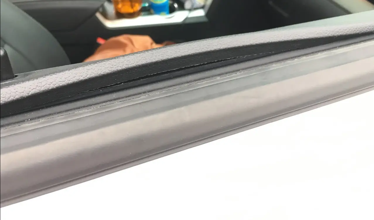

There is a similar if not the same issue happening to our ford explorer. The panel by the window is bubbled up and separated. The first dealership checked on it when it was getting maintentance and they said it isn't covered and to call customer service for help. We are now dealing with airbag light due to seat belt airbag wiring harness (posted info on another thread for a state recall to get it covered) and I noticed the following FSA on our explorer.
  • FSA Title: FRONT DOOR TRIM PANEL REPAIR
  • Field Service Action Number: 17N04
The dealership is checking to see if that covers our door panel problems. I will report back if it does.

wow, the photos above are disgusting. between that and the armrest splitting (mine has split twice, the original one and the warranty one as well) , these door panels are pure JUNK!
