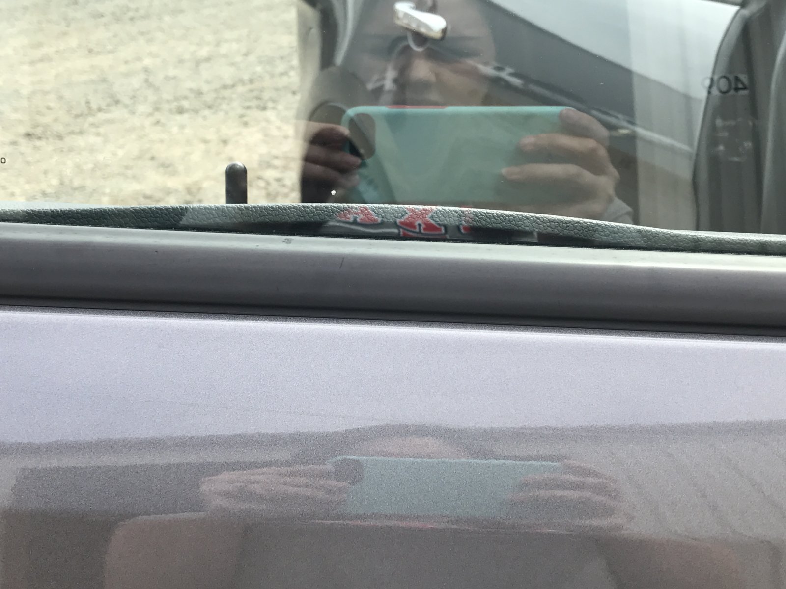

wow, the photos above are disgusting. between that and the armrest splitting (mine has split twice, the original one and the warranty one as well) , these door panels are pure JUNK!

We found this forum looking for more information. My husband drives a 2014 Explorer XLT. We noticed last spring that the driver's side door panel near the window was loose. He took it into the dealer. The dealer said that there was nothing they could do, there was no repair from Ford. They could replace the door panel but it would cost us over $300. He came home and glued it himself. We recently got the recall notice for the door panel coming loose. He took it in and they "fixed" it. But now it all bumpy and looks terrible but the dealer says that it meets Ford's standards. The dealer had told him it was because he glued it, but it looked better before they "fixed" it. The paperwork says it's a one time repair. Does anyone know what our options are? We are not mad at the dealer but want a door that looks good.

I had the same issue after "repair." My passenger side door panel was almost totally unglued. I was going to have my father-in-law fix it until I got the recall notice. I was glad when it came in because I THOUGHT they would fix it better than we could ourselves. Boy was I wrong. They told me they would staple it. After I picked it up and began looking at it, I was completely disappointed. There were wrinkles all over the panel still. I took it back a few weeks later and told the service rep that it looked like crap. He went and looked at it and agreed. He took pictures to send to Ford to ask if they would replace the door panel, in which they obliged. He was a bit surprised how quickly they agreed on fixing it. I now have a brand new door panel. I would push your service department for this. This is an manufacturing issue and they need to stand behind their work.

That seems to clarify the issue. It is the trim separating from the panel, not the panel itself pulling away from the door.
