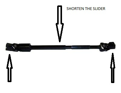

Here's a potential solution,
I have not done this yet but I need a solution soon as well.
I will post up my results when done, but anyone is welcome to have a go.
Here it is:
1989-95 Jeep XJ shaft...modified (XJ's are the cherokee's btw)
Double "D's" both ends: check
U-joints: check
Shaft a little to long: cut to fit at the slider.

How much needs to be cut off the XJ shaft to fit a stock first gen explorer?
