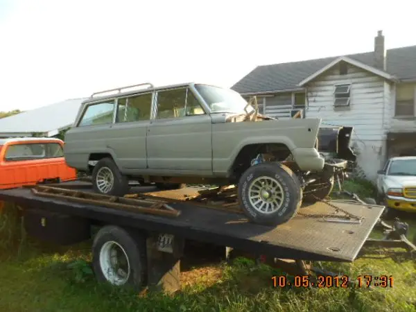

It's official, I now am a proud owner of a Dana 44 from a '89 Grand Waggy. It was originally from Texas, the guy took the body off the chassis and rebuilt the complete chassis, suspension and steering so all I need to do is regear gear it, install greasable u-joints and get a high steer flat top passenger side knuckle. I'll be collecting parts and hopefully will have everything needed for the swap as well as a beater to drive around while it's under the knife.

That'd be cool. I'll probably end up doing the swap in my driveway but will see if there's any room in my custom truck clubs garage since there's two car lifts in it (would make it so much easier).
