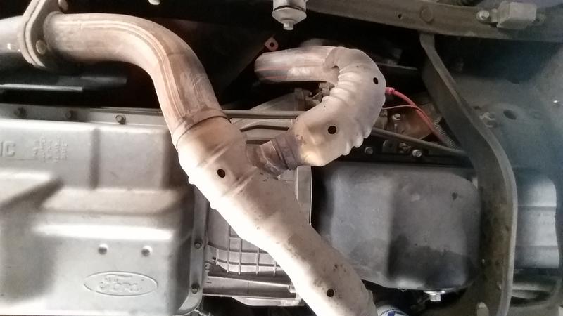

That's because the v10 exhaust sucks at the y pipe. It's my next thing to change on the F250.
