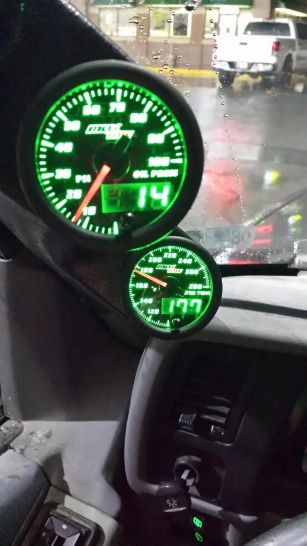

I didn't care for the stock idiot gauge so I installed REAL oil pressure and water temperature gauges.
Cold start reads 56 psi
Operating temperature at idle after 25 mile trip into town
If you're idling in gear with an automatic trans (causing the engine to have low RPM), that's pretty close to normal considering the mileage. Mine would drop that low with a real mechanical gauge once the engine was warm. It's a good thing actually, it means that the oil is flowing nicely throughout the engine. Such high oil pressure when cold is good too, it means that it's thick and the bearings are still thick enough to cause that resistance.
Oil pressure isn't a product of the pump, it's a product of the resistance of the path that the oil takes. That's why if you have really low oil pressure, it means the bearings are wearing out and have excessive tolerance (larger area for the oil to flow through, meaning less resistance).
If you're not idling in gear in that 2nd picture, that might be a bit low. It could also be a warmer climate than I'm in or oil that's sheared down a bit or even gauges that have a significant error tolerance like 1-5%. There's a graph somewhere but I can't find it in my files. I seem to recall that you should have 30-40 PSI at 2,000 RPM. If you're close to that, I'd say you're doing great. 60 PSI is the bypass pressure for the pump so you'll never see anything higher than that at idle when cold.
Still seems pretty good to me considering the mileage. I personally wouldn't worry about it.

Went to town for groceries, and I got a picture of the oil pressure gauge at 46 psi traveling at 65 mph (2500 ish rpm).
The idle pressure is a little low for what I like, but the "at engine speed" pressure is within spec.mine likes to run about 22psi/65psi, BUT i am 75,x.. miles in to a complete rebuild by P/O, and i like to run 5w30 synthetic in the winter and 10w40 synthetic in the summer. being as your engine has seen a few miles, and you live in a warmer state, my OPINION would be to run a little heaver oil.
