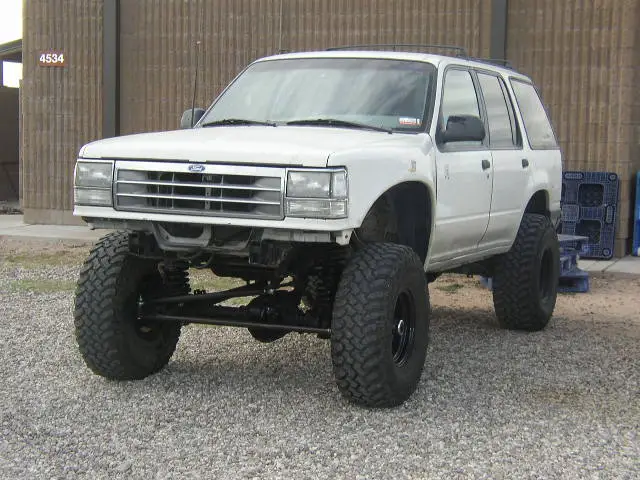

What would it rub on?
As you go to a wider rim (with similar backspacing) the tire/rim sticks out from the vehicle more. When you turn it will make a larger arc and contact the fender more than a narrower rim. You also may have problems rubbing at the top of the fender in the rear, rather than tucking the tire inside the fender.
I like the black wheels. Those actually look really good. I don't, however, believe I've ever seen them on a black truck before. I think it'd look good. Imagine that; black wheels, black walled tires, black exterior paint, and then tinted windows?? I like the idea.
-Drew
EDIT: About the rubbing issue -- you're biggest problem will be your front fenders/bumper. You will more than likely hit those spots with a 10" wheel.
