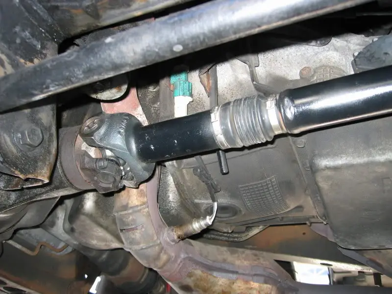

i'll post a few pics of the angles of the driveshaft.

pics are up.
btw, any spatter you see are old ones. right now i have zero leaking seals. :D
here's what the front driveshaft looked like before the ujoint conversion/balancing/painting:

I do still wonder if the u-joint angles may be a vibration problem. I'm not an expert, far from it, but I think basically the two driving shafts should be close to being inline. I know there needs to be some angle of all u-joints, you never want the driveshaft inline with a pinion shaft. Our front pinion angle is very close to being inline to the driveshaft.
I wonder if pivoting the front differential down would improve that angle. I've thought of that before, almost every time I see the clearance at the exhaust there. I'd love to have more space for a 3" cat pipe there.

The driveshaft flanges need to be within 5* on single u-joint setups. Yours are off by about 20* You need a double cardon end with 2 joints at the transfer case.
