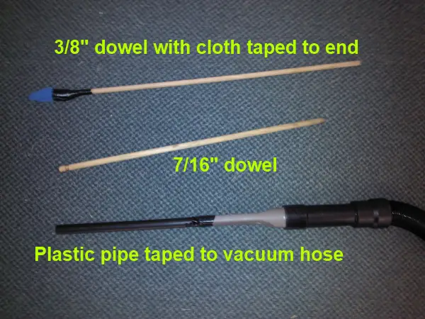

If you READ THIS THREAD under "Cleaning the IAC" you'll see how that acoustic insulator cover is removed off of a 2002 4.6L V-8. While you have the cover off you may as well inspect that rubber elbow hose that is infamous for causing problems. You may decide that now is a good time to clean the MAF sensor and you can see the instructions for how to do that in the same thread. It only takes 10 minutes or less to clean the MAF sensor.
Once you have that cover off simply just use a flat head screwdriver to loosen that hose clamp holding the air intake hose on the throttle body and wiggle the hose off. You could choose to take off the entire hose assembly including the MAF and the air filter cover.
When you take the air intake hose off of the TB there really isn't much to clean. You can clean the opening to the TB. You can clean the butterfly plate. Rather than use an object to hold open the butterfly plate you (or a helper) can grab the accelerator linkage and twist it to open the butterfly while you clean. You can stick your fingers past the butterfly as far as you can and try to clean but really that isn't much of a cleaning. After all, you've barely cleaned into the TB opening at this point. To give a more thorough cleaning and to check to see if you have a plugged EGR port you'll need to look inside the TB. With the butterfly plate open use a flashlight to look into the TB. Look inside at the opposite side of of the TB. You should see a hole about 9" in that is 1/2" in diameter. If you see a bunch of crude instead of a nice clean port hole then you need to clean it out. This is how I cleaned my EGR port hole.
I took a 7/16" wood dowel and poked into the opening of the port hole. If yours is clogged like mine was then twist the 7/16" wood dowel back-n-forth to get it to go slightly into the hole.
Next, make a giant Q-tip using a 3/8" wood dowel and part of a clean rag. Tape the cloth to the wood dowel using electrical tape. Spray TB cleaner into the TB deep inside using the straw that comes with the can. Try to douse the EGR port hole. Soak the tip of the giant Q-tip with TB cleaner and proceeded to clean out that EGR port hole. Next, vacuum out any crumbs. I taped a plastic hose to the end of my vacuum cleaner with electrical tape and sucked all the gunk out. When the cleaning is complete the 7/16" wood dowel will easily moved in and out the hole. The process of cleaning out the EGR port will only take you 5 or 10 minutes.
That is pretty much all the TB cleaning you can do without removing it from its mount point on the engine. I hope this helps and good luck with it. It rather is simple, inexpensive and quick to do.
