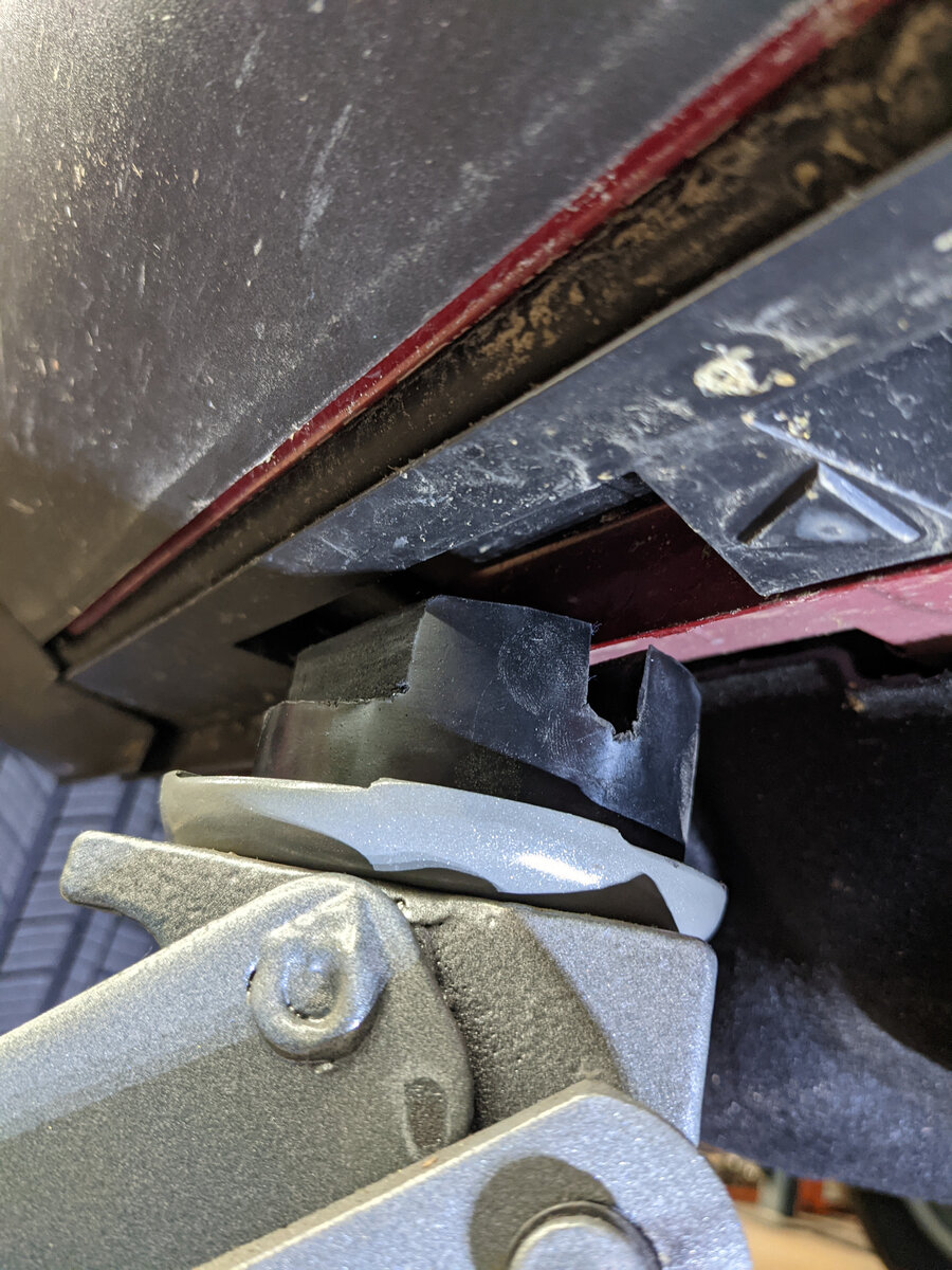

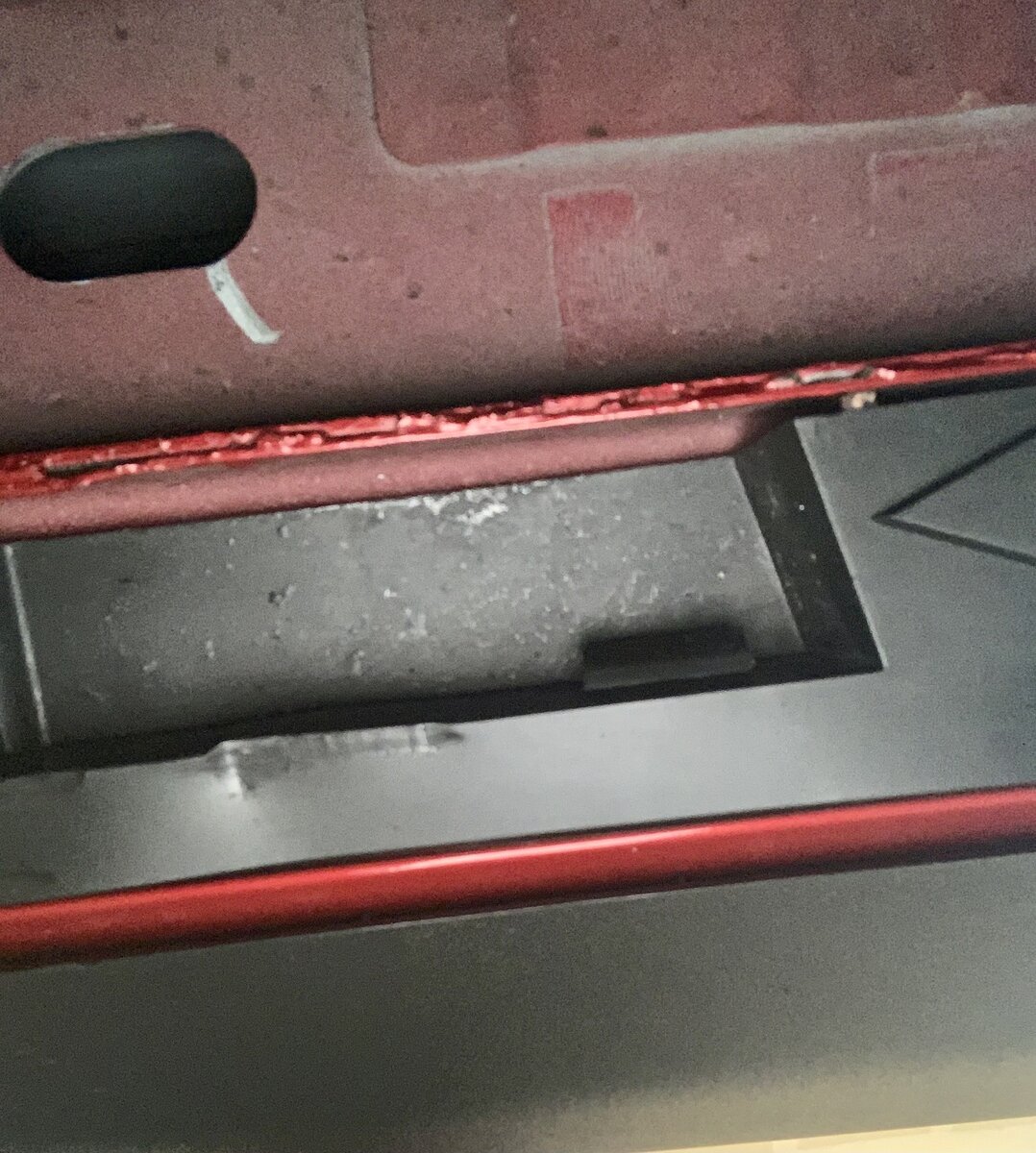

Here is a close-up shot of the rear one on a 2021 explorer

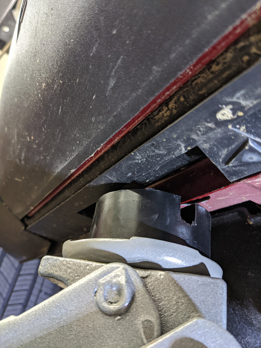

Normally I use a hockey puck with a notch cut in it to put on my floor jack. as you can see in the next photo, it doesn't fit in the narrow notch that Ford provided.
I wound up cutting about 1/4" off on one side to the depth of the notch to get to it to fit.
Hope it helps someone else.

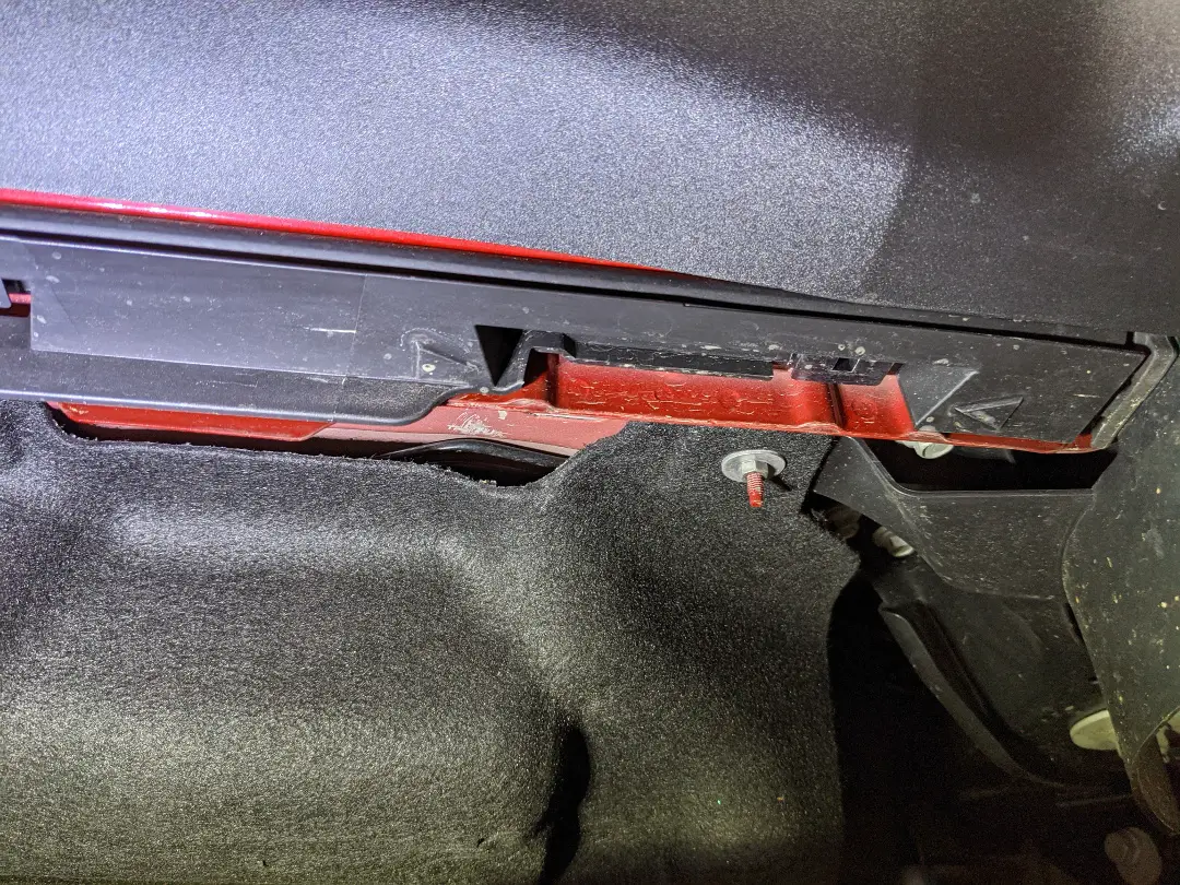

My dealer keeps damaging that plastic part near the lift point every time I go in for oil change. He says, the plastic is so flush to the lift point, they have tried everything but it is impossible to avoid it with the lift equipment they have. The supervisor did say that if it ever cracked or broke etc., they will replace it under warranty because he is confident it wouldn't crack. Fingers crossed. I love this service place, they are awesome in every way with all the Ford vehicles I have had. I would appreciate your thoughts.
