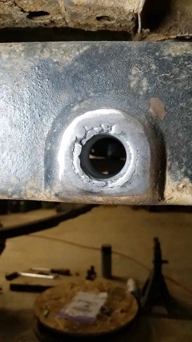

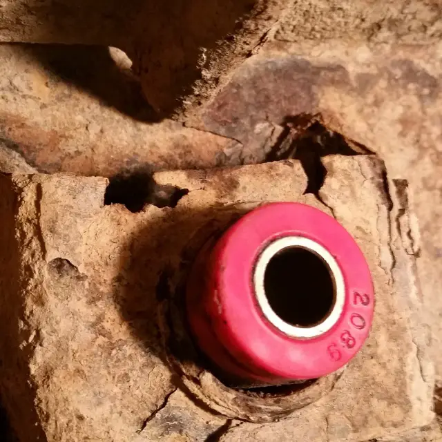

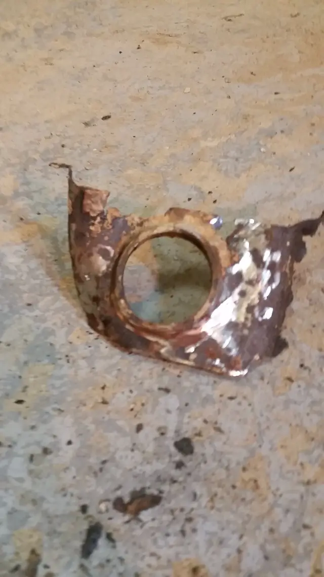

Ran into a bit of a problem while changing out the rear frame shackle bushings.. found a bit of rust. Bummed me out big time. It only took a small pry bar and a couple wacks with a hammer and the bracket was off of the frame. A friend and I managed to cobble up a new mount with some tubing and a piece of c channel fabricated out of 1/8" angle and plate. I think it turned out ok for using random pieces of scrap I had around the garage on a Friday night.

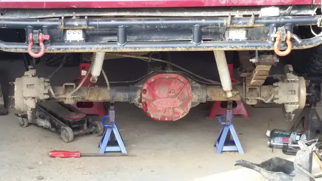

When I had the leaf springs out from under the truck I kept eyeballing the perches thinking something didn't look right. I walked outside and looked at the back of the axle and immediately had one of those 'ahhh (bad word)' moments.

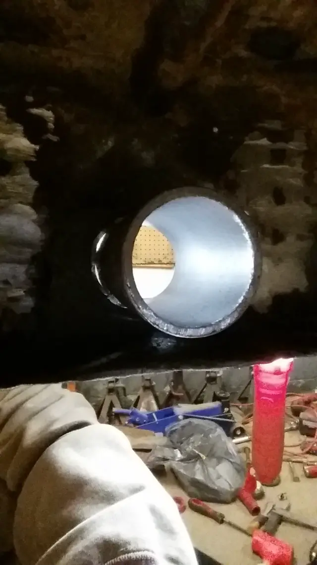

Driver side tube has spun somewhere along its journey with me. Any advice on the best way to remedy this? The more I think about it this has been like this for quite some time. And yes, I know, I should have welded the tubes to the housing. Shame me later.
Rust fix looks damn good.
Spun tube... man as cheap as EX 8.8's are in the junkyard, i would be tempted to go buy a "new" one, swap all my stuff into it, weld the tubes (WELD THE DAMN TUBES!!!) then use the old one as a paper weight.
With that said, this is how i fixed a buddys heep AMC 20 way back in the day-
Get the rear up on jack stands, weld the "not spun yet" tube to the jackstand. Get a big ass pipe wrench with a cheater bar and paint some alignment stripes on the tube and center chunk. You lean on the wrench while a buddy watches the marks. When it's back right... tack it. Then weld both sides.
It worked once- it may or may not ever work again. :D
I have another 8.8 and thats prbly what will happen. I still have dreams of 8 lug wonderment and if I pull the 8.8 out from under this pile I really want to put something else in it. But for right now it works. Going camping/wheeling this weekend so we'll see how my shackle repair does.
Torched the LH perch off, welded on a new perch level with the RH side, welded the tubes to the center section. Its back on all fours with no leaf spring clap around turns or over bumps. She lives to wheel another day.. well hopefully more than a day, I'd at least like to get a few more years out of her.
