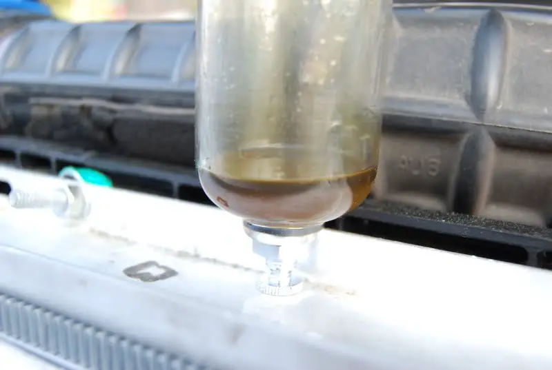

oh yea jd, that filter has 3x as much in it now! i never empied it before, i just wanna see how much comes out.
i seemed to have lost the ring that holds the mounting bracket on. in doing so my pcv was just barly on the cover cause the filter thumping around lol
some zip ties fixed that. i do need a better way to mount it tho
Dont let it get to full.
yea ill empty it, it doesnt have much in it now, since its so big.
any suggestions to keep from pcv from wiggling half-way out? you can see how i mounted it in my pic. but the pcv keeps coming out a little bit, prob making a vac leak from it
it wouldnt go back in there with the heat shrink on it :( too tight
so i adjusted my brake booster vac line and the filter. may work better this time.
stupid me, i sprayed brake cleaner in the clear plastic tube on the filter to clean it out, now the whole thing is frosty and i cant see in there :(

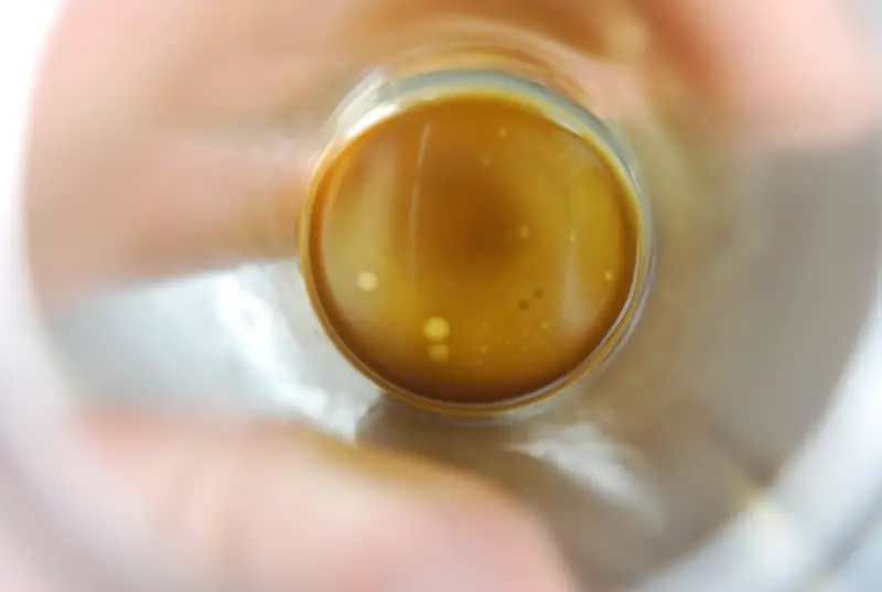

what i took out:
i also changed the oil, makes me feel a little better
Thats not that bad more oil blowbye that water.oil change is allways good.ps dont ever use a fram!! Plain simple motorcraft
