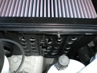

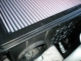

thats sick, thanks, just what im lookin for, not tryin to spend to much money but i wanna hear SOMETHING out of my v6. really wish i had the v8 bc i love the sound of the roar but i deff gotta try it out once i get some time. seems like its shouldnt take too long anyway. do you have any pics of it?
limited view, but i have holes drilled now in the front side / fender side / back side of the lower portion of the box...
i kinda messed up a few holes in the front, but it does the job...
Dang you really put some holes in that thing! I only done a few. I think that just taking off the silencer will help on the mounty where it runs to is right behind the headlight. I just think it will breath better now. How about putting some screen over that big ol gapping hole? Any need in that? I Think I may put some more holes in mine. But then the screen over the hole would be useless right. Well any air goes into the motor has to go through the filter anyway so why worry.
