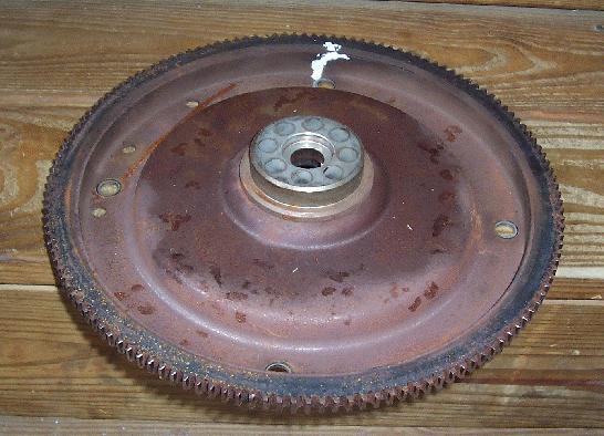

flexplate spacer?
Did you install the flexplate spacer?
Sometimes it sticks to the old crankshaft and gets overlooked.

The one in the photo was on my 2000 Sport. The flexplate for the automatic is thinner than the flywheel for the manual clutch. The spacer compensates for the difference. You keep posting flywheel but your posts indicate you have an automatic which has a flexplate.
Yes sorry for the confusion. First automatic I've wrenched on. My flexplate is definitely thinner than yours. I'll do some research and see where this shim is placed. Thanks for your help!
Found the issue. Spacer was not installed I overlooked this on the last engine. Bummer I had to drop the trans but had to be done.
