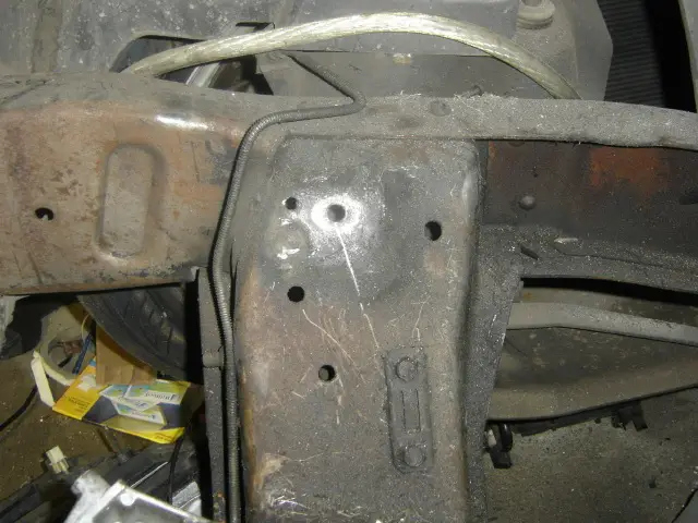

I have a 4WD X frame here @ the house, and the holes are the exact same...
Ryan
Here are the pics of the 2 frames that I have here @ the house to show that the holes are the same...
#1) 2WD Drivers Side
#2) 4WD Drivers Side
#3) 2WD Passenger Side
#4) 4WD Passenger Side

they should bolt right up man, the L&L mounts fit my 88 perfectly as well as a 93 4x4 frame we have done
they should be a direct bolt in for you??/
I have pics me thinks.... let me look
The kit I have is for a 2WD. Because that is what I have. Should I have bought the 4WD kit? because the 2WD and 4WD frames are the exact same? And more closely resemble the 4WD Ranger frame.
Ryan
explorer frames are 4x4 frames 2wd or not, I am not sure about the Ranger 2wd vs 4x4 engine cradles, can you call L&L and ask?
I agree the landl instructions were pathetically useless.
Yeah yo need the 4x4 ones. Or drill new holes in yours.
