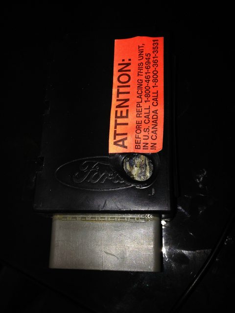

I have an 1997 Limited 5.0 AWD Explorer with factory daytime running lights.
My passenger headlight was not working on low beam...the fuses and the bulb were fine.
Read this thread and fixed it! Thanks Explorer forums!
How to:
1. In the centre console remove the error message centre, it's just snapped in place, no screws. Careful use of a flat blade screwdriver will help. Leave the wires attached and place message centre towards the drivers side.
2. On the passenger side of the inside of the console there is a black box (LOM) with a grey connector. At this time you can attempt a "wiggle test", in my case the passenger headlight came back on!
3. Remove the LOM by removing two philips screws, one of them is very difficult to remove. A 90 degree ratcheting bit drive was very helpful.
4. Disconnect connector.
5. Carefully pop open the black box.
6. Check for burnt circuits, I had NONE. However, looking at the top left of board (bottom side of the board). I found a very small crack in the solder joint for the connection for PIN 11.
7. Complete the solder repair
8. Re-install
Passenger headlight works AND now my fog lights work too!
