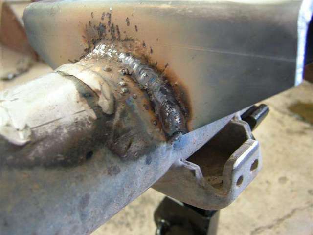

My project is temporarly on hold- I intended to do the SOA tomorrow, but my perches aren't here and I have to work. :( The good news is its all time x 1.5 :)
Perches welded on:
I used 7018 rods that I baked in the oven, welder ended up being set at ~140 amps to get good penetration.
They look pretty good, the pictures I took didn't turn out very well at all.
looks good, but you need to brush that thing clean so we can see your handy work !!
It's hard to tell with that picture if you got good burn in on both surfaces, but it looks like a very steady handed weld :thumbsup:
140 amps with 7018... way more than enough. I'm sure the penetration was there. bet those welds went down quick too!
yeah that looks like a solid weld. i wouldn't worry too much about penetration on a piece of plate at 140 amps!
