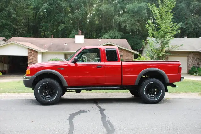

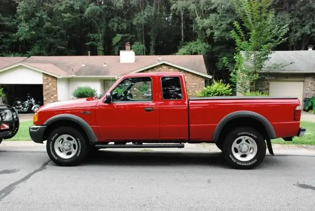

3" body lift with 33" tires is plenty to hit the trails. My vehicle is a daily driver but handles the trails very well. I don't go full tilt boogie or anything like that, but we have fun. But, I don't tow anything with it.
Here's a before and after pic of mine with just 3" lift and 33" tires. Yeah I know, it's a Ranger, but you get the idea LOL.
Before Lift:
After 3" Body Lift and 33" BFG TAs:

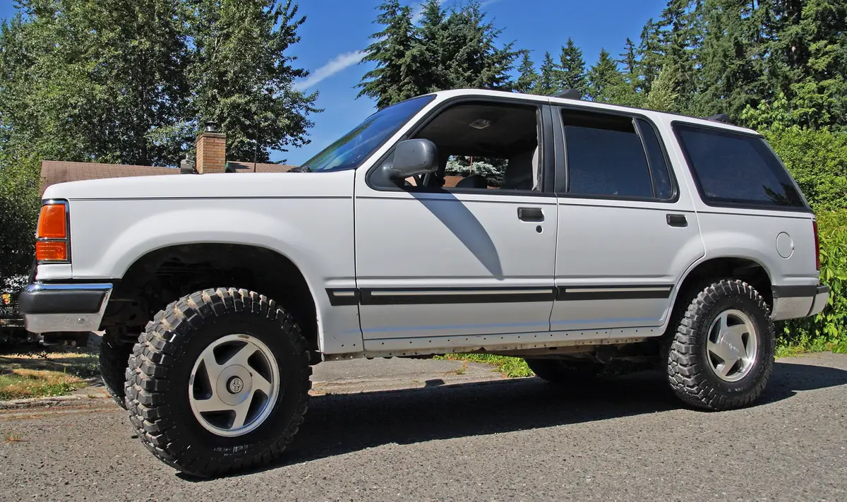

Did mine on the low budget side of things. 1 1/2" Lift Rough Country fronts springs which ended up giving me almost 2". 2" shackle lift in the back. 31" KM2's. I can and have run a *majority* of the WA trails. In deep snow I am just fine with Albino 94LTD plowing the way. :notworthy
Ricky, your set-up looks like it would provide just barely enough room for chains. Much like mine. Your first gen does have a slightly different front fender cutout shape than my 3rd gen. Your photo should give tire iron a really good idea though.

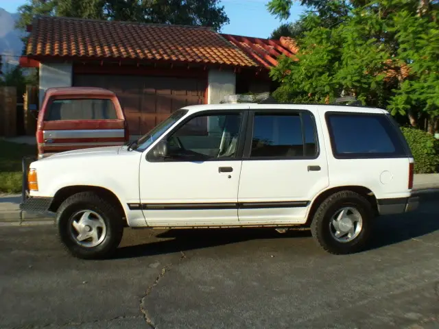

my '93 xlt (just like yours) is stock suspension with 31" x 10.5" tires (pic below) and the tires will rub very very slightly on occasion when it is fully articulated and the wheel is turned one way or the other. if i ran chains, i'm sure they would catch as they would be adding another 3/4 inch or so to the tire height (and width) on each side. Therefore, i would recommend you do not exceed 31" tires.

here's a pic of my '93 xlt on 31" BFG's with stock height.. notice the rear sags a little here, i would probably also benefit from some new rear springs, or add-a-leafs.
from what you do, i don't think you'd benefit much from a lift, or large tires (wider tires don't help for icy conditions any either) i'd recommend gear down, better shocks, new rear springs (or add-a-leafs) and 31" tires.
