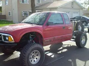

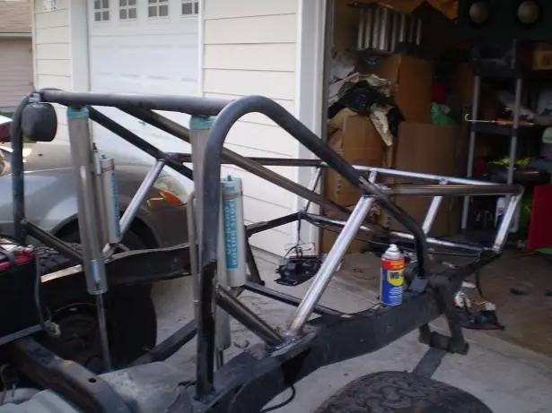

yeah, wife took it off insurance while i was in Iraq to save some money and stored it in fallbrook at her aunts house. since it wasn't in the aunts name home owners insurance didn't cover it. total loss. now i have an S10 with 21" long lower a-arms and burly upper j-arms with king coilovers and fox bumps, in the rear i have deavers with long shackles and king bypasses with fox bumps on the way. got a 4.3L auto with a ford 9" sittin on 33"s......added to the shock hoop today and turned it into a bedcage. still working on it.
