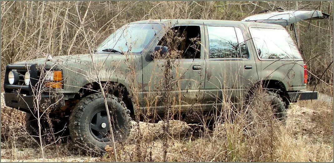

I am about to buy new tires, going with 33's this time instead of 35's. I noticed I have negative camber (pic doesn't show it well but you can see).
I have a 4" suspension and 3" body lift. How does lifting affect camber? If I got taller springs would that cause positive or negative camber?
I ask because I have 2" metal spacers and if I found taller springs to get another inch or so and ditch the spacers would this be worse on the camber?
Thanks!!! Scott
If you lifted it another inch or so, your tires may sit correctly. When you lift the truck the tires lean out, it looks like yours lean in.
Optionally you can get some camber shims. Napa has them in many different degrees. About $20 each except for the 4* which are $45.

Thanks again! I will read that too. My steering works good and drives straight, my only complaint is when I get in the ruts a big rig left in the street and I think that is from my worn out boggers? I took it down to the creek and over some twisty terrain and was not pleased with the flex...but it never thought about getting stuck.
I thought about doing the axle flip out back and the bigger springs up front and keeping the 35's but really want to enjoy it for now. I think the way it sits now 33's would be a better fit?
