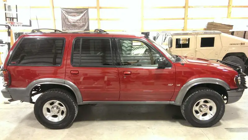

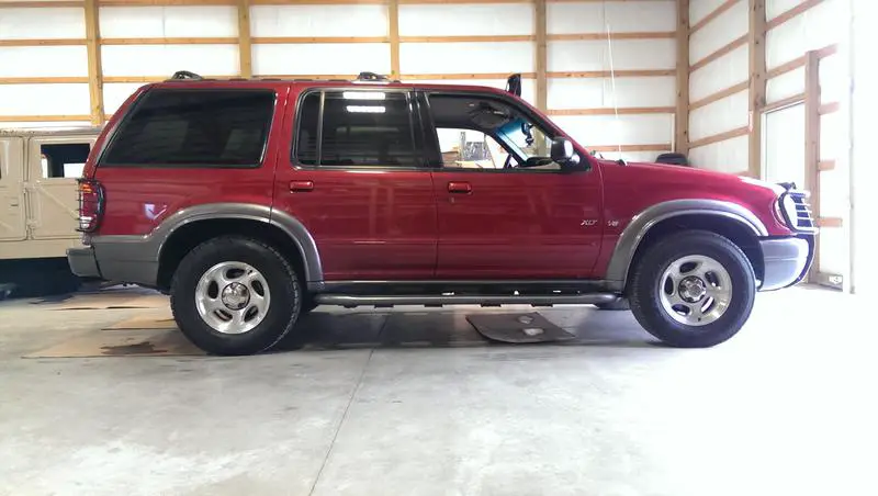

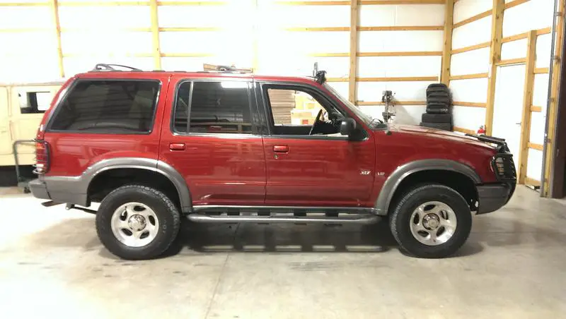

Looks awesome bro gotta love the red. I ditched the running boards on mine for more clearance.

Can anyone post a pic of a stock ride height explorer with 31s?
Curious how mine will look with a bigger tire.
TIA

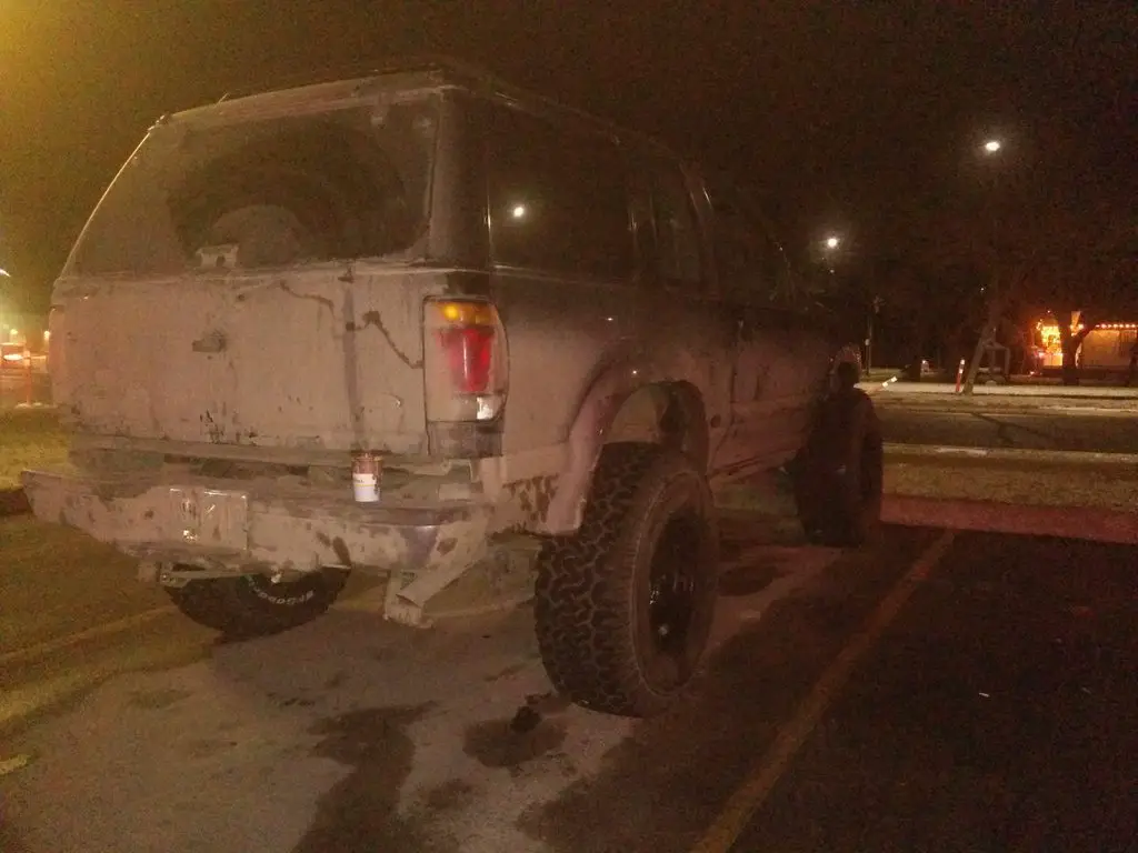

1.75" in front (tt), 3.5" in the rear (monoleaf + cut down main from a sonoma as a second with custom shackles), 3" bl, front fender and bumper trim.
35's.
