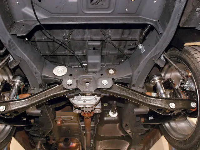

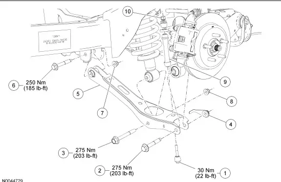

From what I can figure the suspension is the exact same.
2007 Sport Trac
2007 Explorer
I know the pictures aren't the best. But if you go to Autozone.com every part such as springs, bearings, brake pads, CV axles are the same for both vehicles.

Roadbully and I have checked into this already. His spacers would work on the 07 up Sport Trac. It uses the EXACT SAME suspension as the 02-up Explorer. (I am a Ford dealer tech BTW) I will be the guinea pig in a few months.
