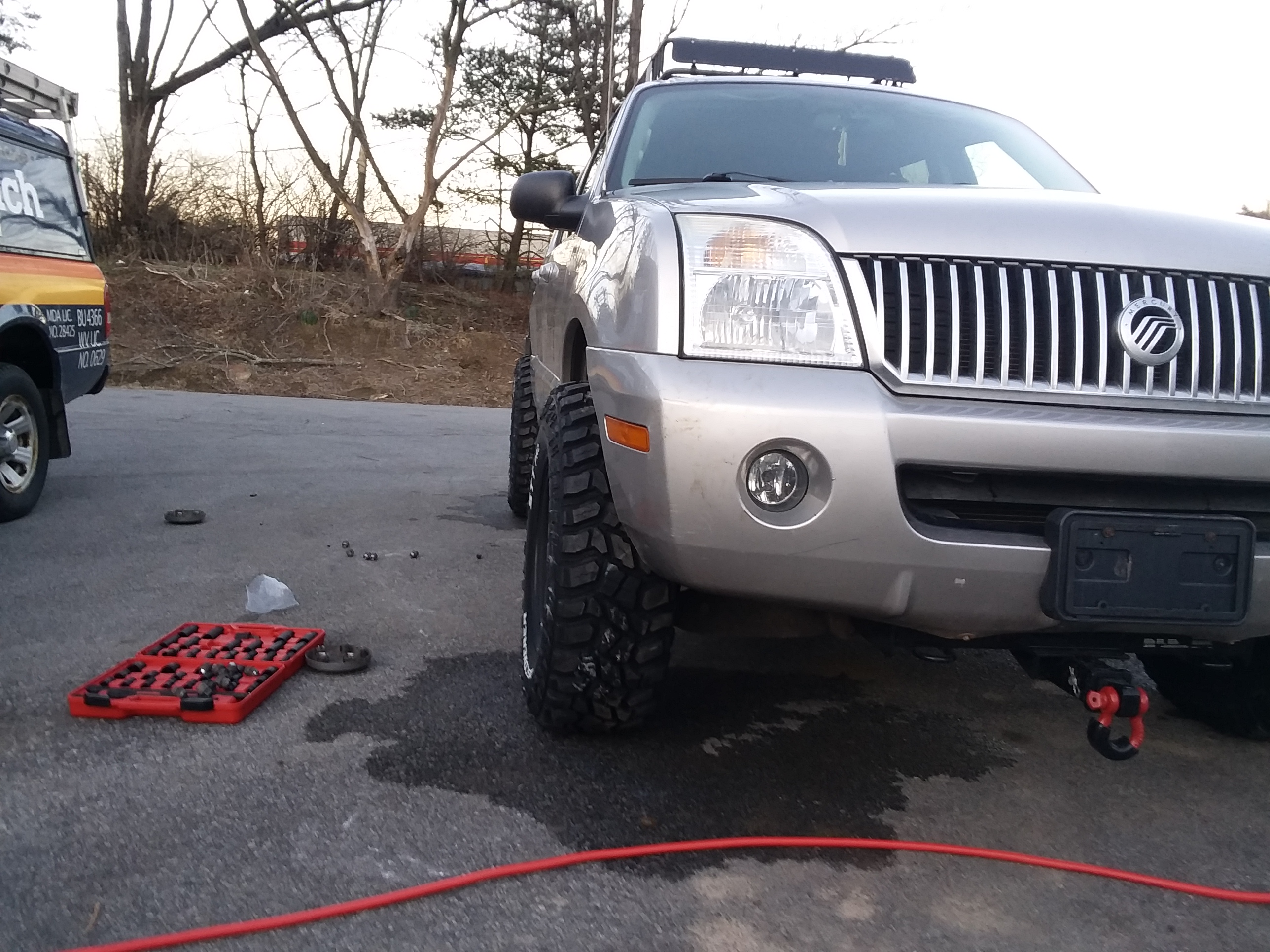

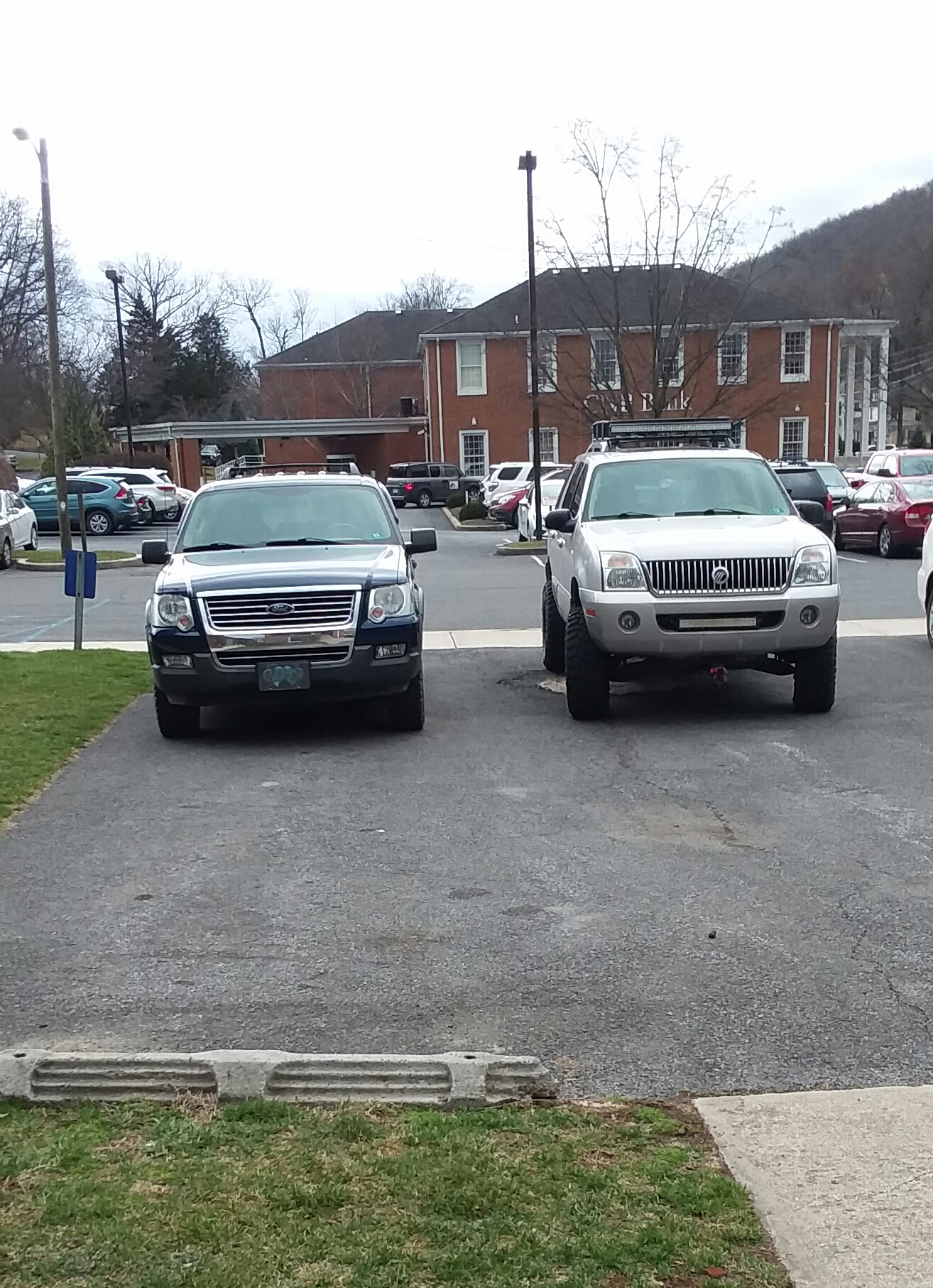

There you go. The last pic (the one where the truck has no lightbars) is before the suspension lift. Just posted to show the wheel offset
Nothing crazy, like I said it's only been a few weeks. I took it up in the woods and found some **** to go over to get a few wheels off the ground here and there. Didn't take pics though. These things arnt exactly famous for their flexing abilities but I was happy with the amount of travel. It's a beast in the mud. When it comes to serious rocks it will never keep up with a solid axle, but you show me a hill climb or a mud pit and I'll give you a run for your money lol Bottom line: It's no $50k trail rig, but for what it is, she does quite well. Better than you might think.
