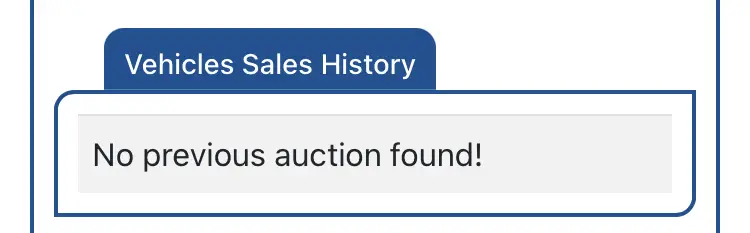

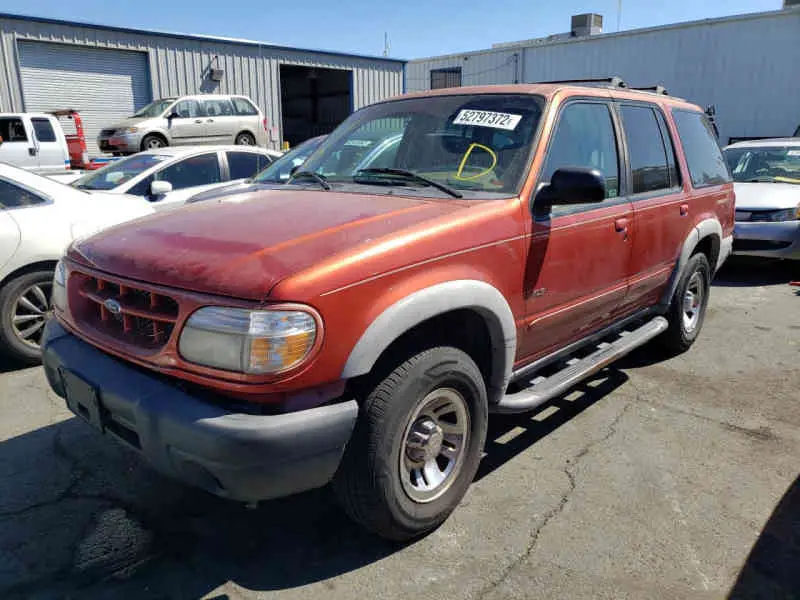

If you go by NADA High Retail is $3650, Average Retail $2575. S-title =-30%. Granted low milage, but not a 5.0. Run away from this one.Hey Guys, I really appreciate everyone's concerned on the Salvage vehicle, that really make me twice, I decided to do my due diligence before spending so much money, I bought the car report for this vehicle from this site Detailed Vehicle History Report For any Vehicle - 100% Accurate, (which is CHEAP), there's an auction records for this vehicle saying
but when you look at the pictures there seems to be no serious damage, the bumper is falling a little and other than that I see nothing to be worried about, what do you guys think? The car was sold for $750
Primary Damage Front End
Here is the car report: https://app.detailedvehiclehistory.com/report/vin/1FMDU32X5XZB50575

Looks clean, but also looks like the front was repaired…front end collision resulted in the salvage title?
