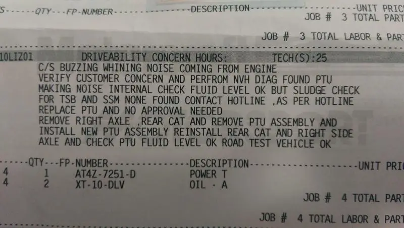

Hi all,
Just thought I'd post my results. Here is what the techs had to say..
The whining sounds are gone - lets hope for good.
