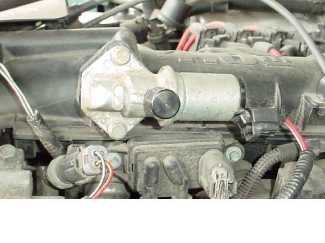

tnx for the reply got any idea where the the idle controller is
take off that plastic cover that says 4.0L SOHC. Its sitting right underneath it, and is attached to a wire and harness. Just unclip it and 2 bolts takes it off. Installing a new one takes all of 10 minutes.
That is an excellent link with a lot of detailed pictures. Here is one picture from that thread:
tnx ordered one today, took it off and it looks dirty inside. New one will be in monday and ill change it. I wont know if it works till the summer comes.
