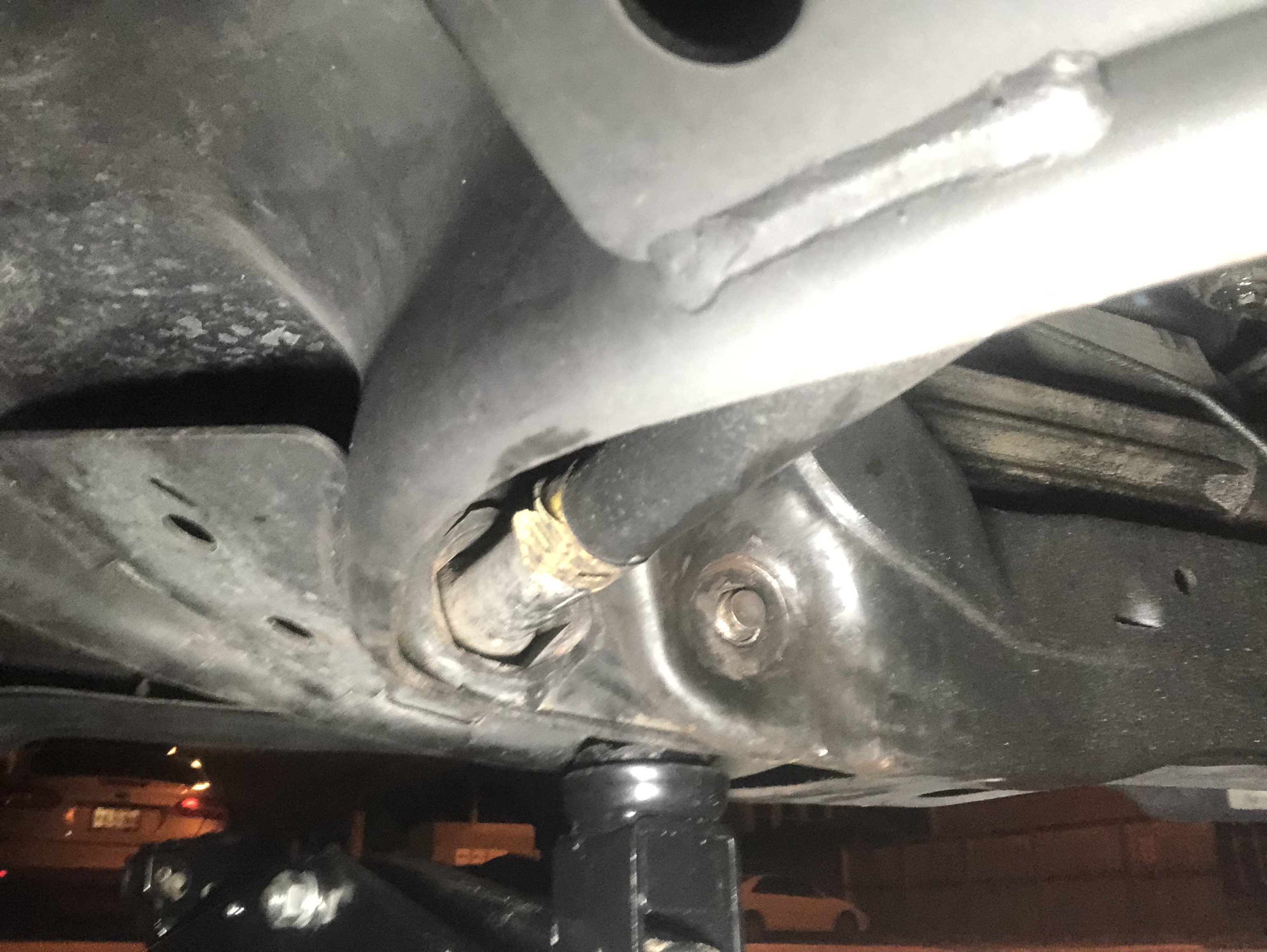

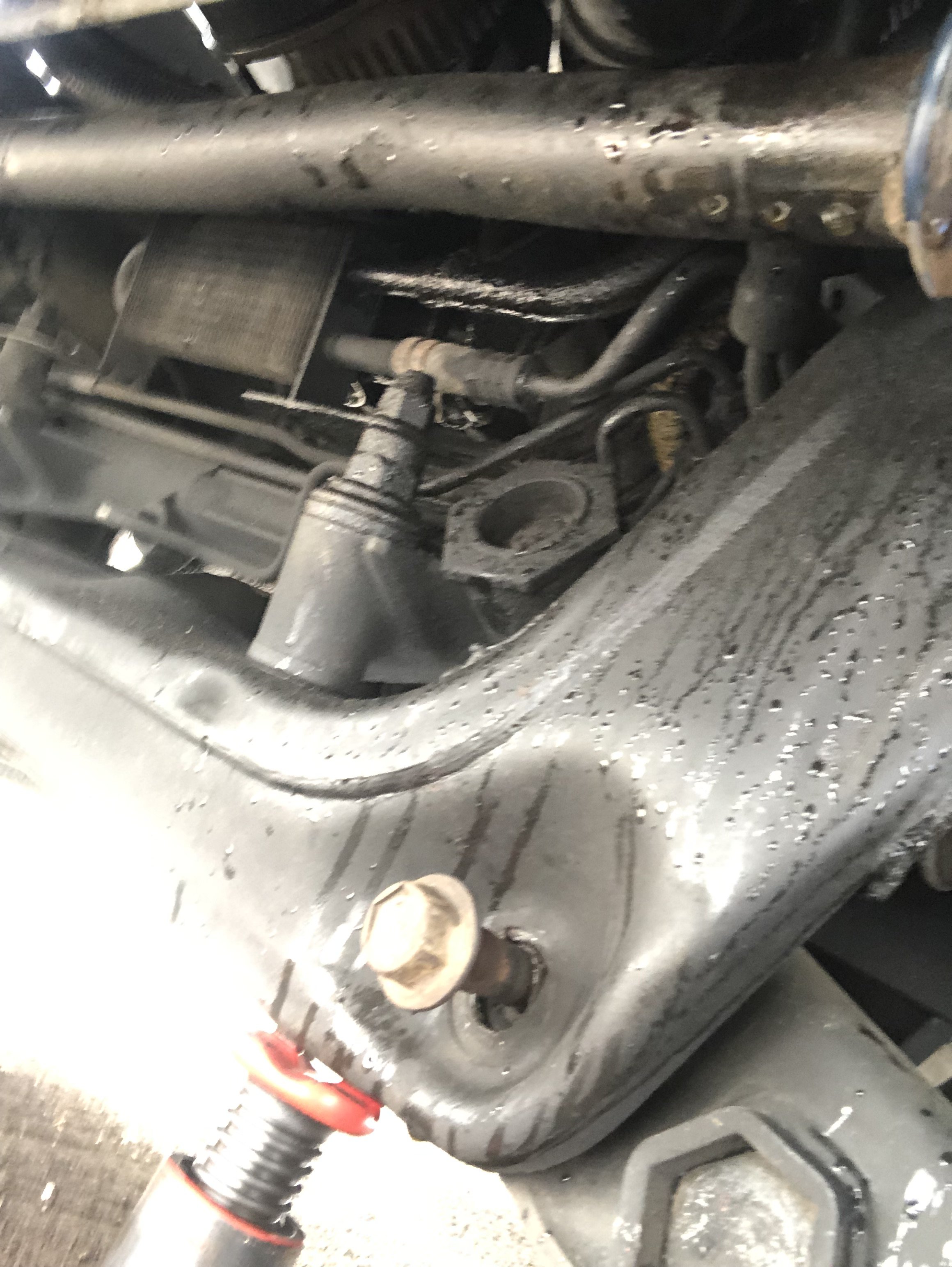

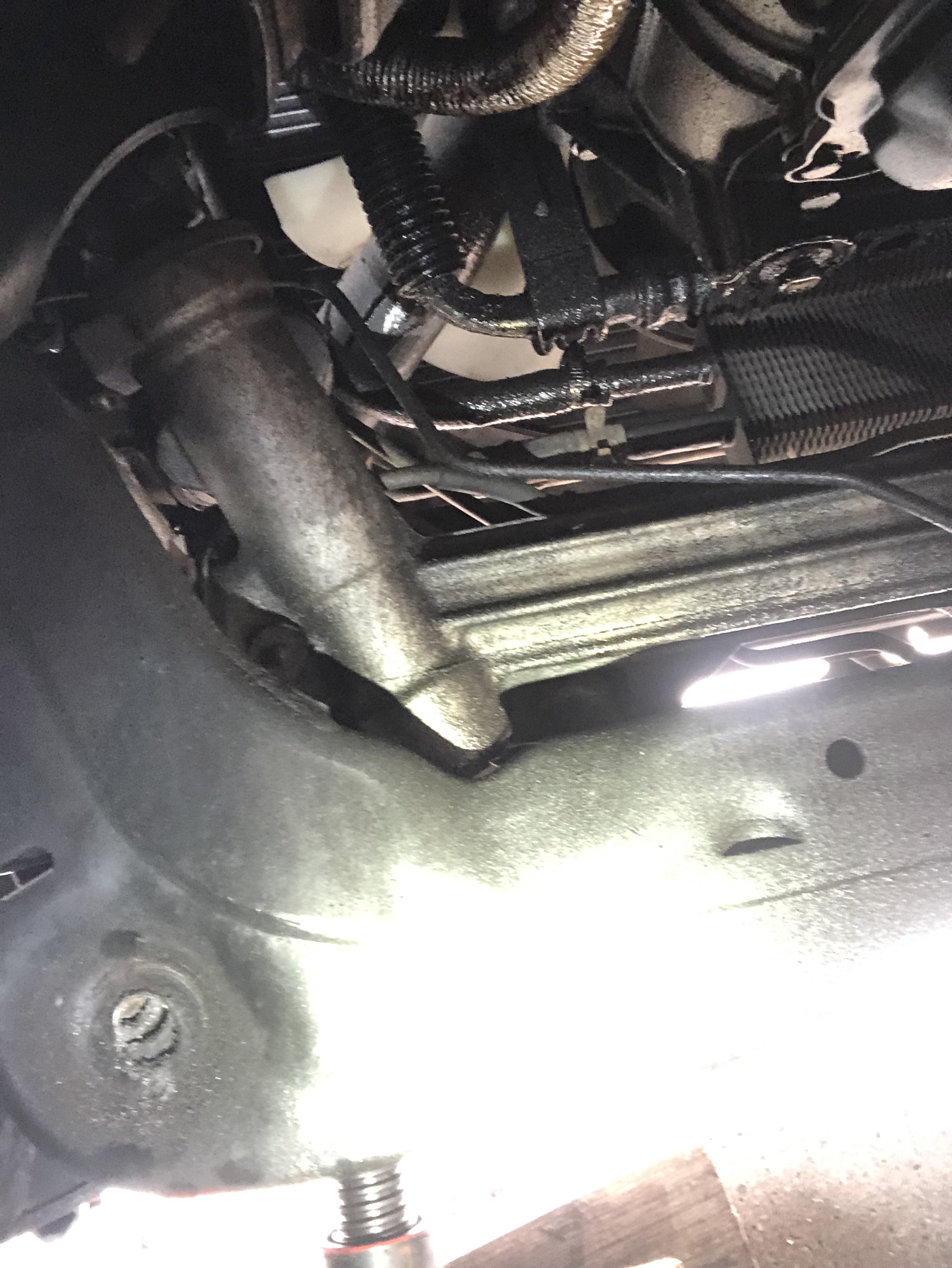

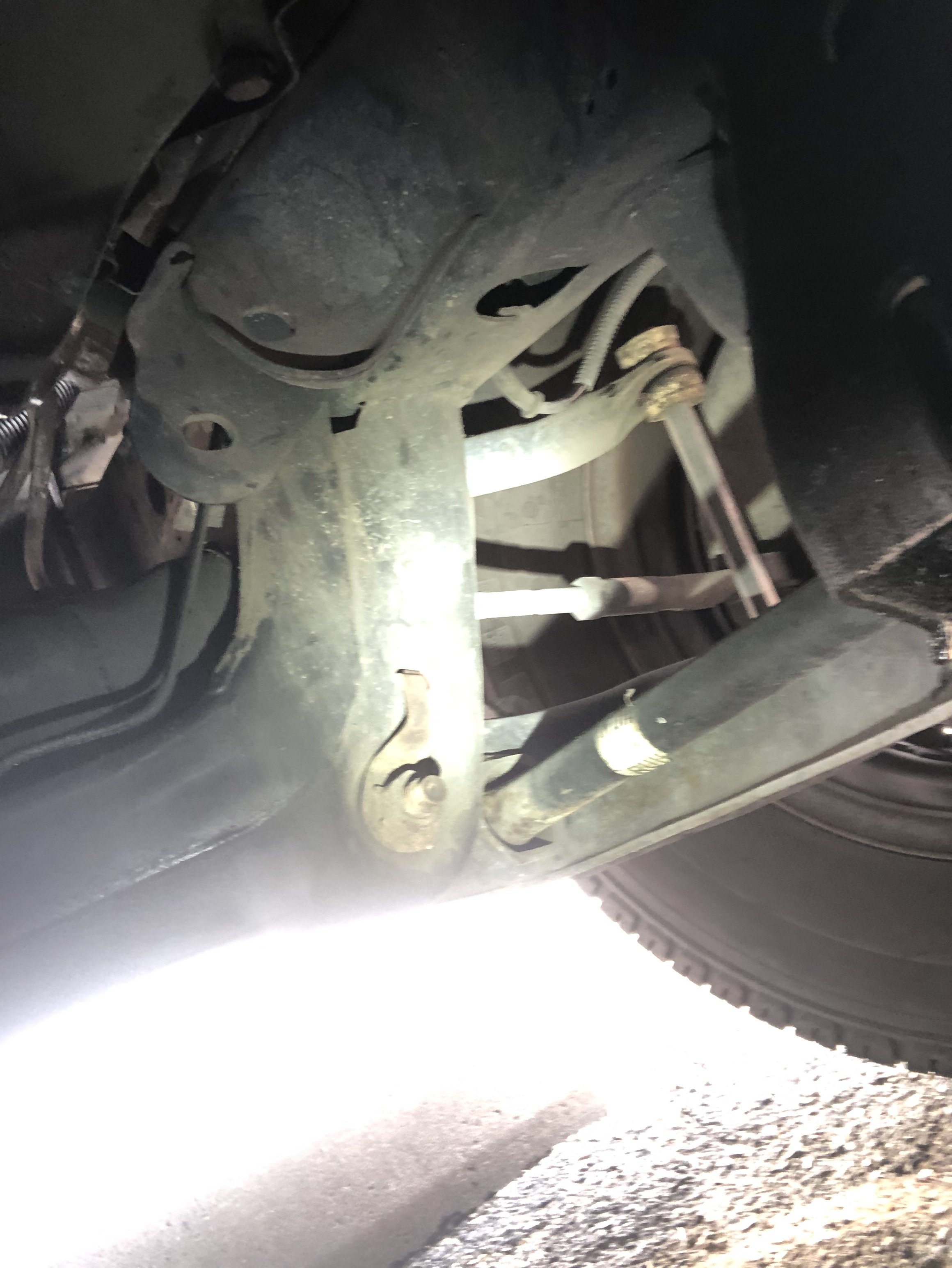

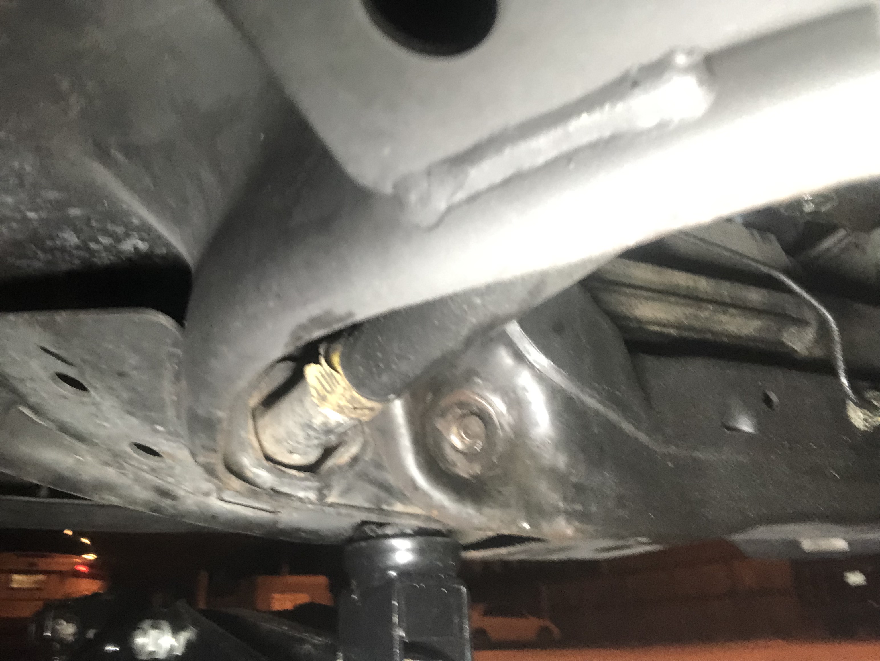

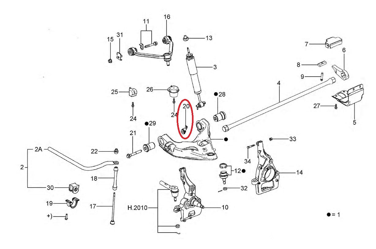

Hi guys , need your wisdom) my Lowe control arm bolt is half way out and nut and this fancy washer is missing. Bold stock and not moving in any direction. I believe this is the part where CA attached to the frame or its most likely subframe. I attached pictures. I was trying to jack it to take bolt out with no success. Do I have to release the torsion bar? Is there any procedure that align these holes and take bolt in or out? Plan is ( if treads are still there then find the nut and put everything back together. And what about washer or whatever it is missing?? What to do about that? Just put regular washer and search for used one ? To attach pictures of the driver side with misaligned holes and bolt halfway outb. And another picture is the right side for reference on the washer or whatever it is called. Thanks god I was removing radiator to replace the wire harness on crank sensor and discovered it . Thank everyone in advance. Max

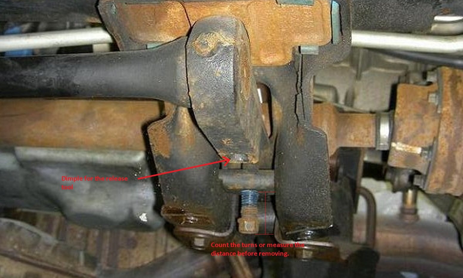

Youll need to get a floor jack under that arm, And loosen the torsion bar like @wollimann says. Make sure to count the turns as you unbolt it to approximate your ride height and preload. I just wrote mine with paint marker on the frame.
after you loosen the bolt for the torsion bar adjustment, you can lower the control arm with the jack and swing it down, it will alieve the spring tension and allow you to remove the torsion bar.

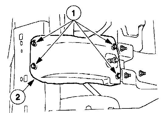

First remove the cover plate

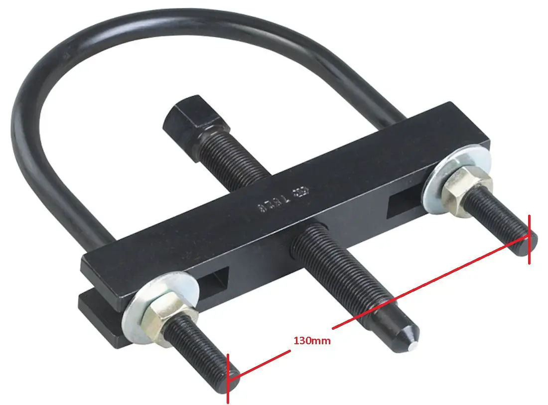

Be careful, lot of preload! You can use a two arm puller but you have to secure it
so it can't be slip off!

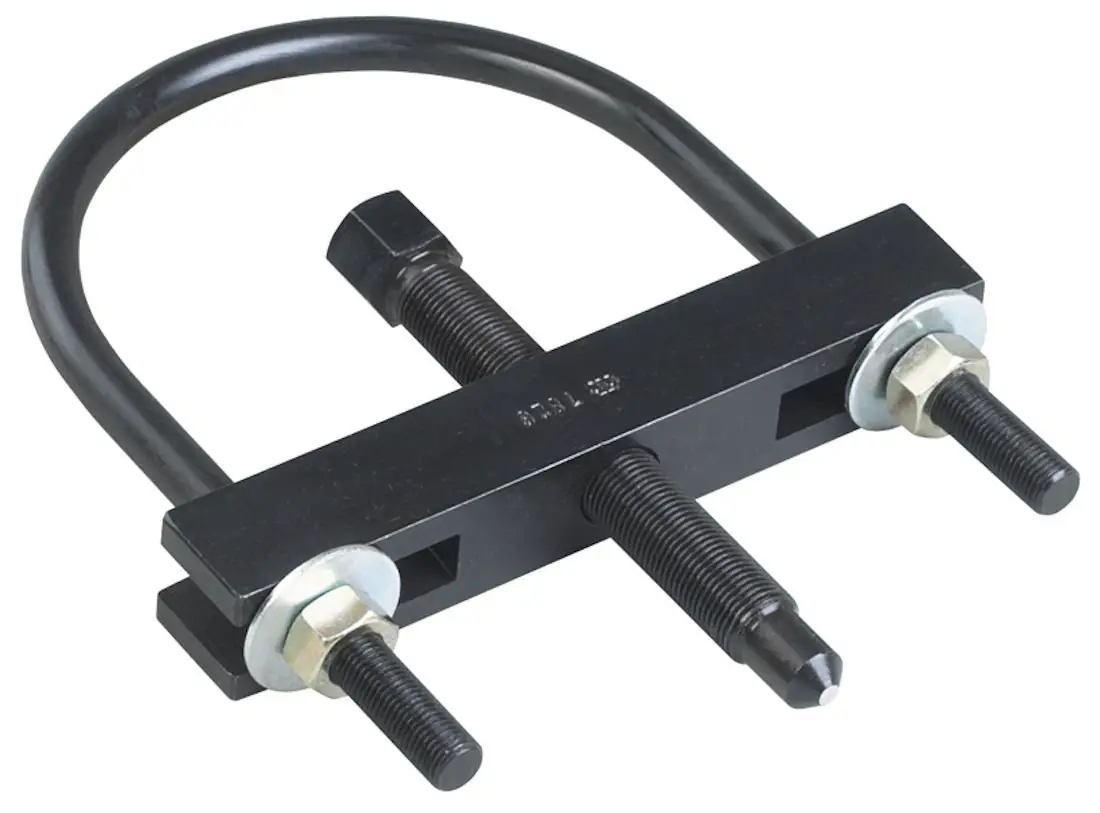

Awesome. Thank you! I was removing them few years back, my 2 jaw puller didn’t work on them well, do you know the part number of tool you posted before? Thank you for stepping in. I already purchased the washer from eBay.

Here is the tool wollimann was talking about

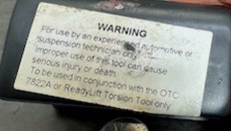

What you bought is not a OTC tool,
the seller didn't read the sticker, only this part will be used in conjunction with...
The real OTC 7822A is a GM tool
sorry for that

Hi . I replaced all front end few years ago and did whole job with 2 jacks because my 2 jaws puller didn’t work on that application) I promised myself that if I got to do it again I will do it with the puller. I did not replace this rubber pads ( didn’t have time to order them) . Puller I got should work, it’s 5.5 inches wide. My old pads were green in color) but not completely rotten but I will be happy to replace them ( or at least one for now)

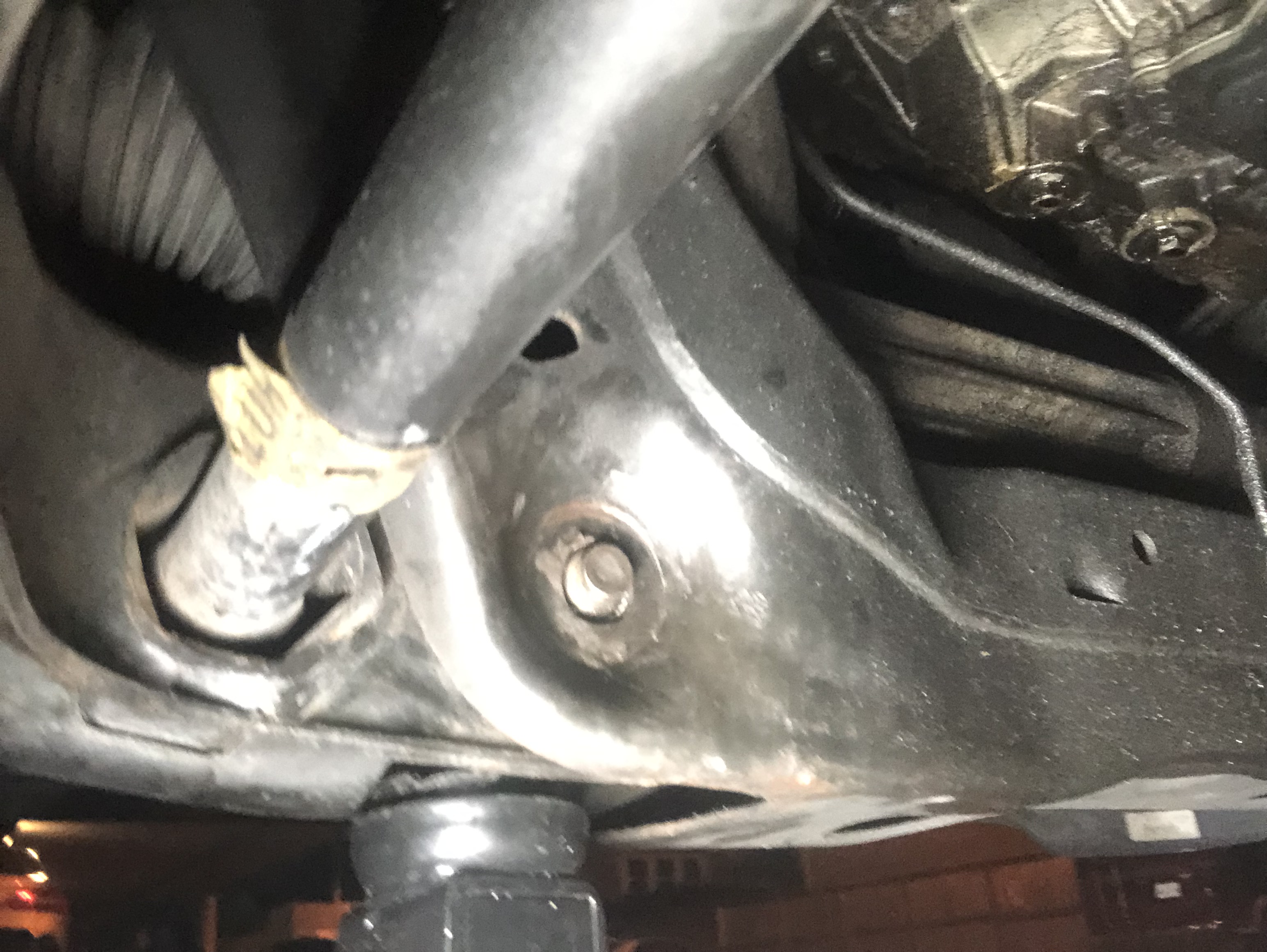

Hi guys. I am still struggling to align this holes. I was jacking subframe and was able to push bolt a little but not enough. It’s also not coming out. Torsion bar released. Any advice? Thank you all in advance.
Lower control arm must be fully released, so you have to support the subframe, not the LCA.
Looks like the bolt is not centered in the frame hole.
Any other parts (Tie rod, knuckle, cv axle, maybe torsion bar) should be removed
prior to get out the LCA completely.
If you only want the bolt to came out, jackup the frame and let the LCA hang down
with loosened UCA joint.
Did the bolt spin free?
If not, maybe the bolt and the LCA bushing is still a unit, rusted together.
If so only wd40 and force will help to push the bolt out, but threads will be damaged.
