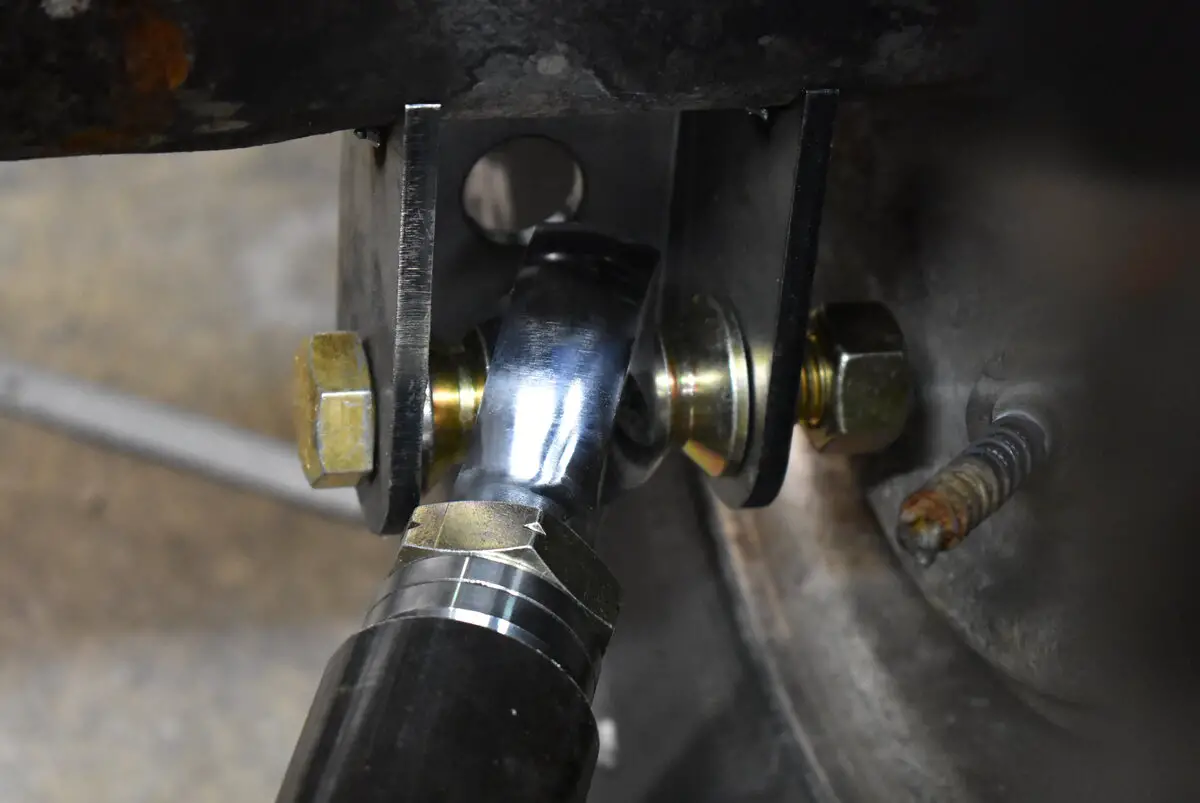

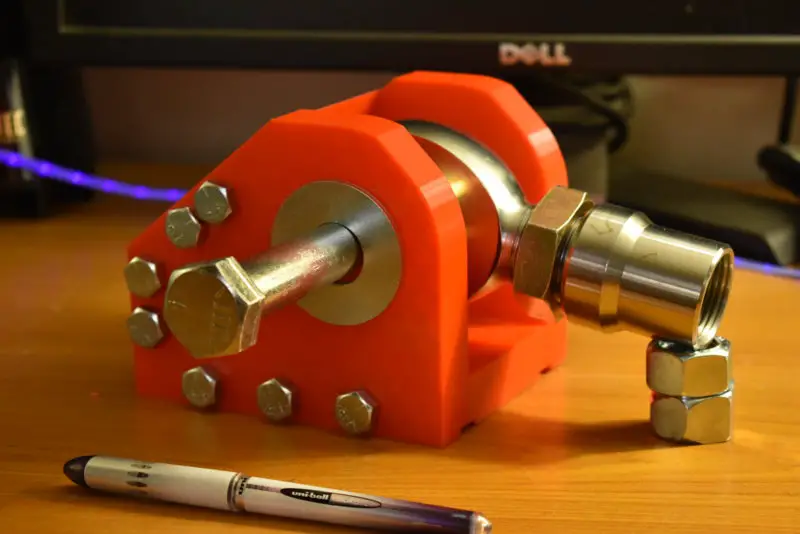

And today's task is drawing up some sketches to mount this thing on here....
EDIT: Here is what I came up with:
My game plan is to 3-D print this for mocking up sake, make any needed adjustments or tweaks so everything clears, then machine the plates, bolt them together, and finally weld all the seams. I'll keep yall posted!
Well.... got the bracket printed. There are a few dimensional things I need to correct, and I need to drill out the 3/4" bolt hole a bit more, but I think the general concept is going to work. I think I'm going to spend some time trying to trim a little wasted space off the bracket footprint. Next I need to get the arms ordered and figure out what I'm going to do for a cross-member so I can start mocking this stuff up!

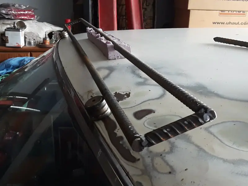

I used magnets and some foam to kinda 'levitate' my rebar pieces into place. I cut a slot in the piece of foam so that it wouldn't go anywhere. After I kinda got things set where I liked them, I marked the rebar with where it came in contact with the magnets and then just traced the magnets on the roof so I could take things off and put them back on while maintaining some 3 dimensional position.

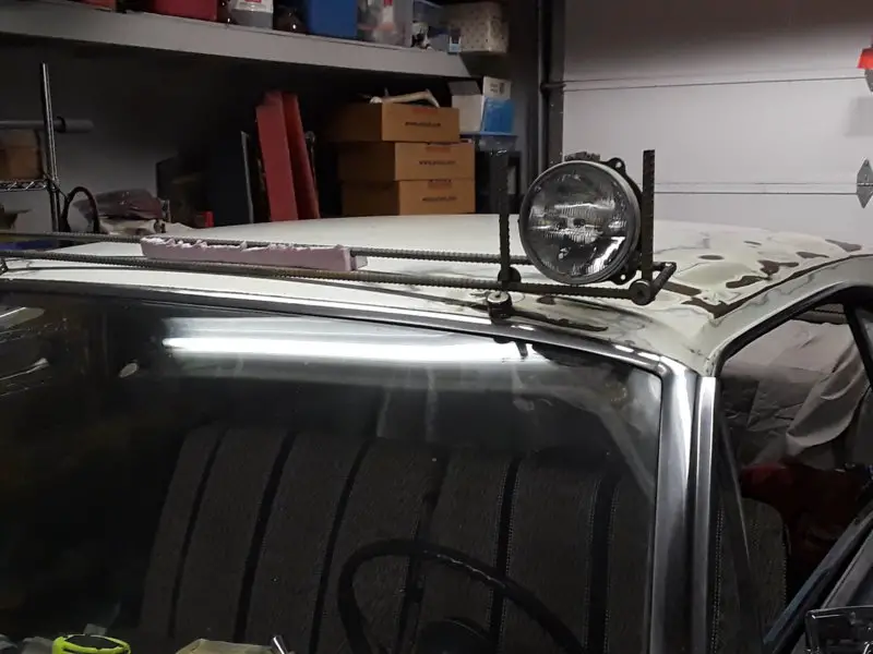

I popped it off, welded the ends up, realized I was a bit rusty at welding, and grinded off the excess. After which I mocked-up what I was going for:

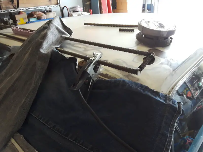

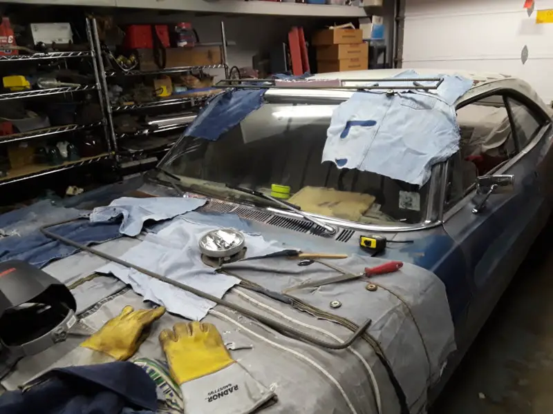

So today after work I was able to snag a rebar bender from Uncle Bill (who has all sorts of cool equipment!) and got to work bending a top piece to fit onto my little rebar square... It is on the hood of the Junker in this next picture:
After cutting it up to where I felt good my sister was able to come out and give me a hand holding it in place while I tacked it in. Surprisingly we got it pretty dang straight and I was able to finish welding the upper 'hoop' onto the square. Here is how it looks tonight:
And again, the lights and little connecting bars are just held in with magnets to kinda demon-straight what I am going for.

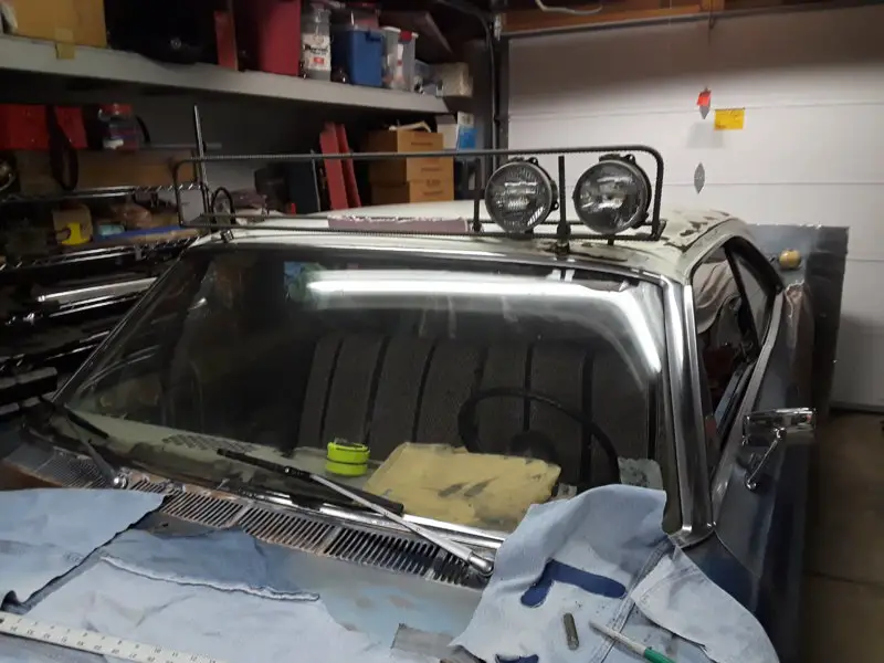

Anyhow, I was able to get the middle bars cut to length and tack welded in. I need to finish the welds and then bend the rear hoop for the top of the light buckets to mount to. And then figure out a way to bolt all this stuff onto the roof. Probably do something with rubber gaskets so it is water tight?
This last picture kinda shows the backside of the headlight buckets and the holes I am attempting to line up. If it all works out I'll just drill and tap them right into the rebar.

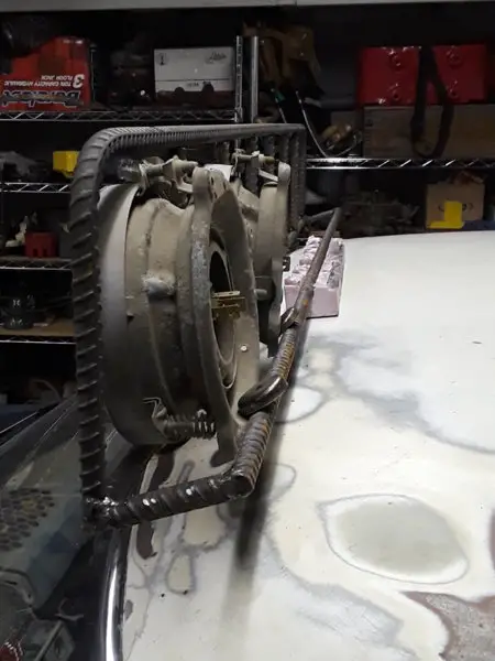

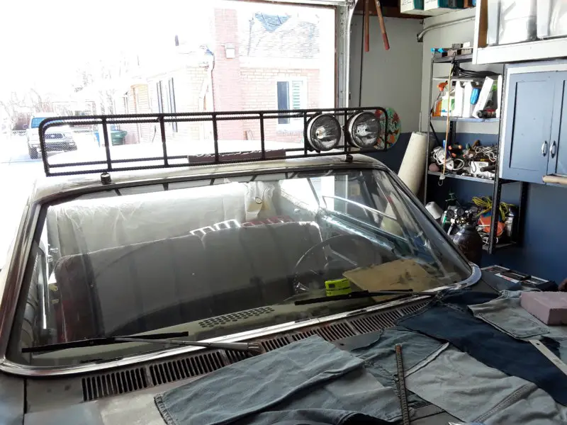

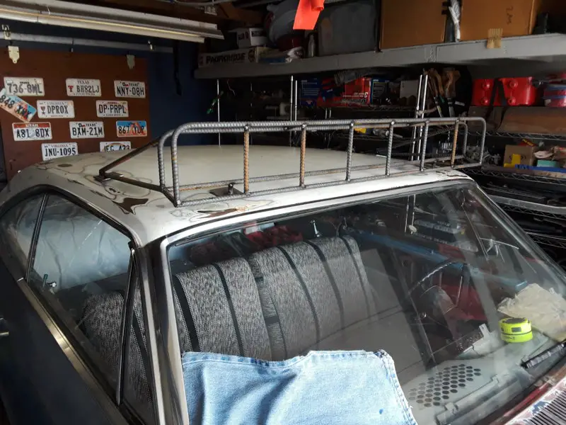

Well I had a reasonably productive afternoon today! I started by getting the rear hoop bent and cut to size, then hoisted it into position and measured, measured, and re-measured where I had it placed before I started tack welding:
Upon getting it tacked, I re-measured and felt very satisfied with where it ended up:
After which I welded up all the tacks I had left from the evening before and added 2 braces at the top between the two hoops. If there is anything that can be learned from this next picture, it is that I am the proud owner of a denim welding table...
My next step is going to be figuring out how to anchor/bolt this whole assembly on. I also want to add some additional supports/gussets sloping back farther along the roof line, however, I don't know if I want to leave it open or cover the top & sides with expanded steel?
I'm leaning towards painting the whole thing flat black when I'm done.

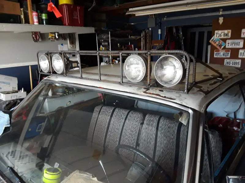

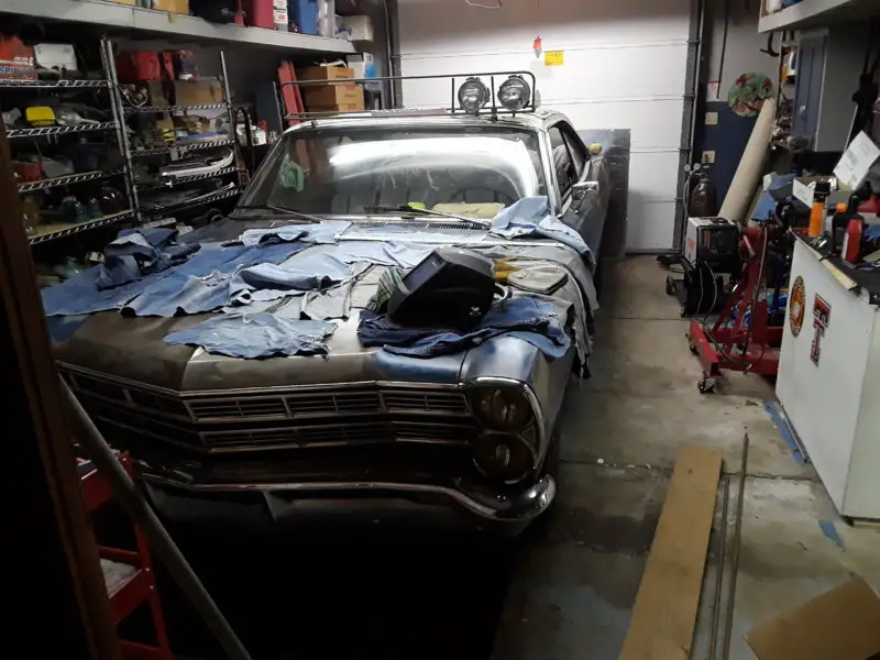

So... We had some warm weather today (32-35) and sunshine so I finally made the push to get this thing resting under its own weight. I ended up welding tabs onto the whole thing in 4 places that I will drill and bolt to the roof. The tabs are 3/16" thick and I still need to drill for the 1/2" - 13 bolts, which will keep this locked solid onto the roof.
As you can see, the tabs are relatively low key, but I will probably paint them some form of rusted off-white to blend a bit more with the roof. Luckily, matching the paint isn't a priority.
I couldn't help it, I had to pop the headlights in and get a teaser of what is to come. I'm very happy with the results :) Still need to track down 3 more headlight buckets though... going to look at some out of a 1963 Buick Electra a guy in the area is parting out. Hopefully they are similar to the Chrysler buckets.
Oh! And I haven't decided where to weld expanded steel onto this thing, or what I am going to weld onto the backside of the light buckets to conceal/contain the wires.

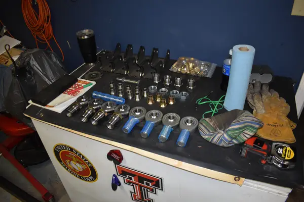

Here is a picture of parts I bought:

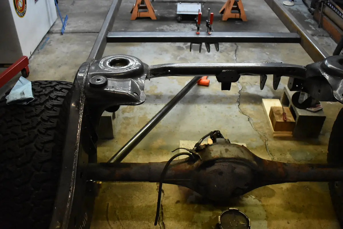

And finally, here is the first cross-member getting tacked in to begin the mock-up of the 4-link for the rear:
Awesome mechanics and artistry.
Looks like a cool project. Can't wait to see the results:chug:
Thanks Rick & Mr. Alligator! It should be a fun time :chug:

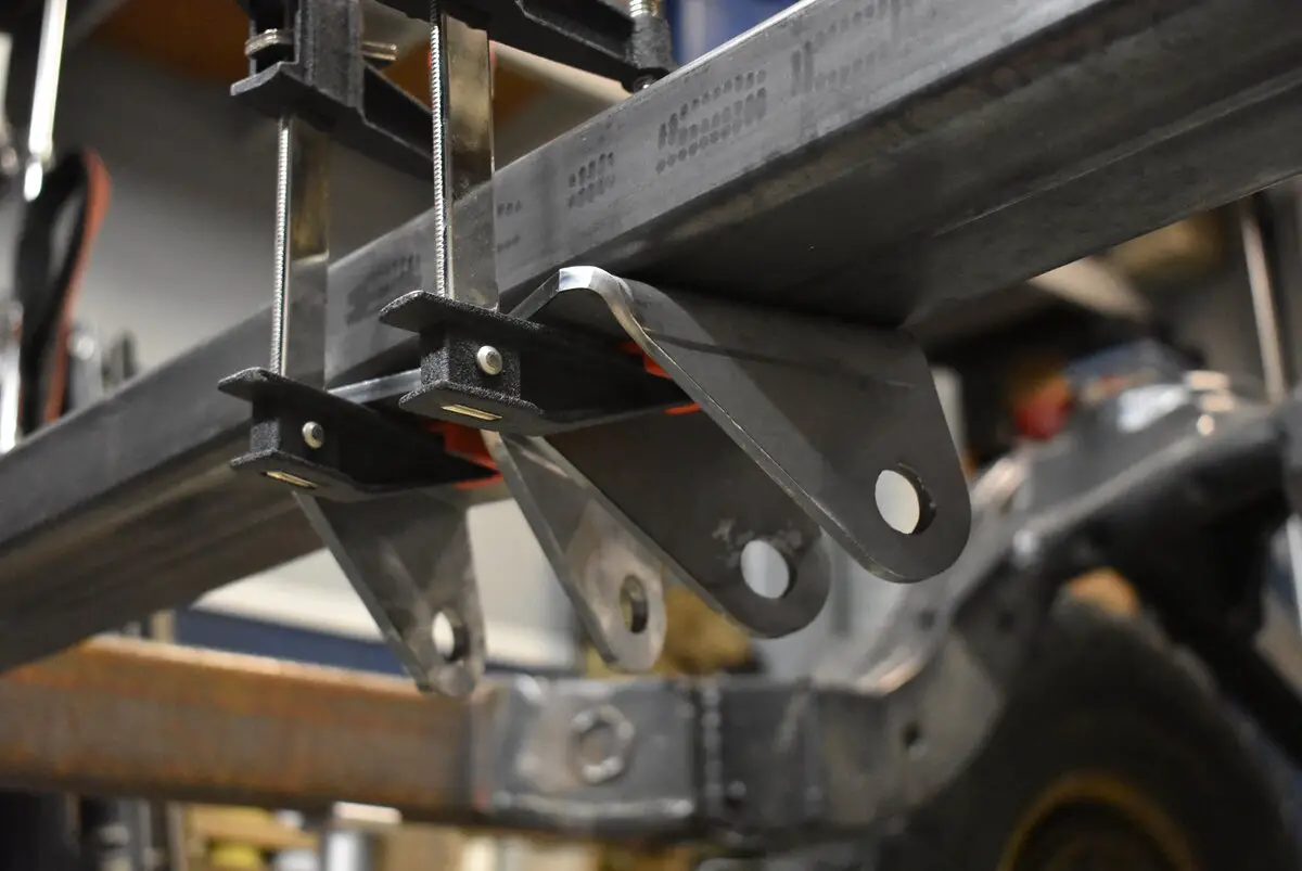

So did just a little more this evening - wanted to tack on the lower link mounts & start to get a feel for how long I need to cut my links down to.
As you can see, the main cross-member is also just tack welded in - nothing permanent yet. I will likely make some sort of a gusset between it and the frame - though, I did replace the OEM frame rails with 3/16" square tubing. I measured out the center and just did some mock-up clamping of the brackets on the bottom side of the cross-member:
Then I leveled and tacked in the brackets I have available for the axle end of things - after which I slid the lower link in and came to realize the angle I have is way to steep for this out of the box bracket:
This clearly isn't going to work! Now I am hunting down something that is ****ed off to the side a bit - maybe a 10° or 15° angle?
This is the only thing I have found so far - available on RuffStuff Specialties:
The bracket pictured has a 10° offset, however, I don't like how tall it is even at it's lowest point. I am going to browse around and see if I can find something better - if not maybe I'll just modify the one I have and see what I can come up with. If anyone happens to have a recommendation I am happy to check it out!
No matter the outcome of this guy - I think my next task is modifying the other axle brackets I have and making a sort of mounting plate for the top of the diff.

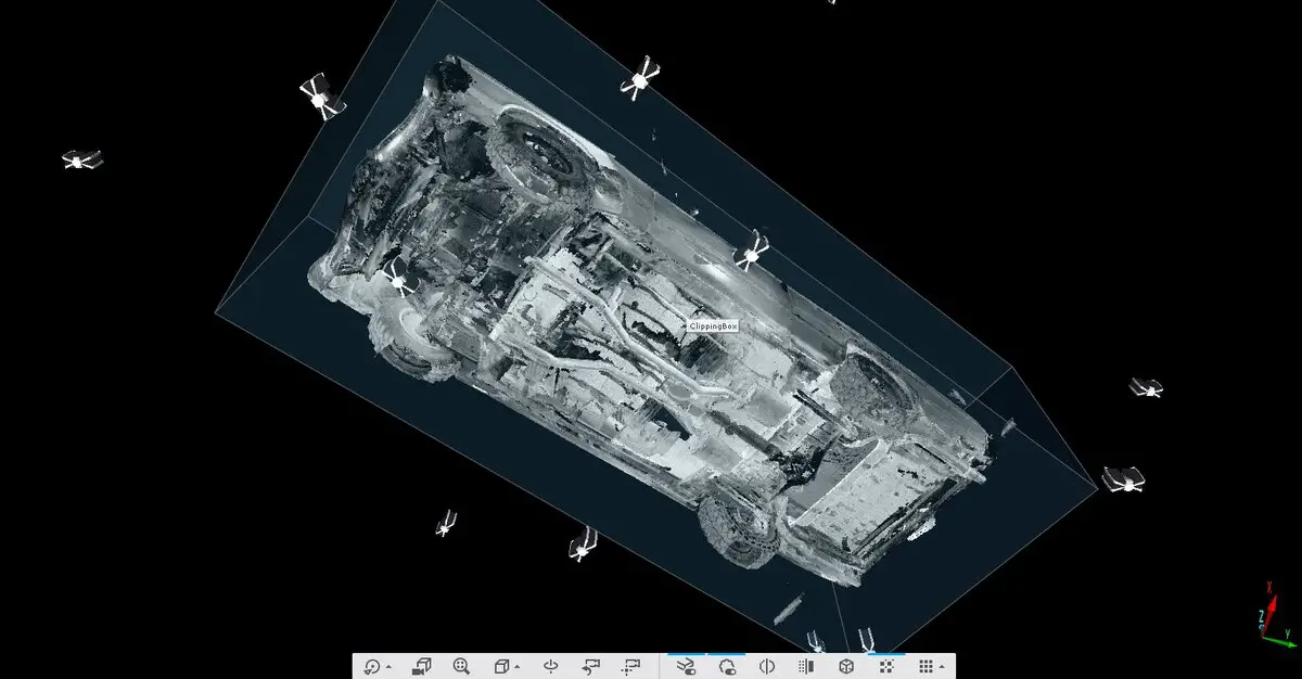

Now, I'm not really good at planning - but I'm going to do the best I can with this thing. We have a scanner at work and 'The Man' happens to be a great owner. Couldn't ask for a better place to work. One of those perks was being able to use our scanner to scan the car and the frame. It also helps that I am one of the engineers that uses this thing on a weekly basis :)
So the above image is part of the stitching process. Long story short - this scanner takes all these scans and has to stitch the scans together to create a complete image. These auto stitched fine (mostly due to good common geometry like flat steel surfaces from all the stuff in the shop) but 2 under the car had to be manually stitched - was a crap shoot this time. Only one stitched ok, the other I gave up on and just deleted.
Below are the shots of the car after processing the scans - stitching - creating a 'point cloud' (which just takes the bazillion points and consolidates them to a few million points) - and cropping what I want as an export to a ReCap file.

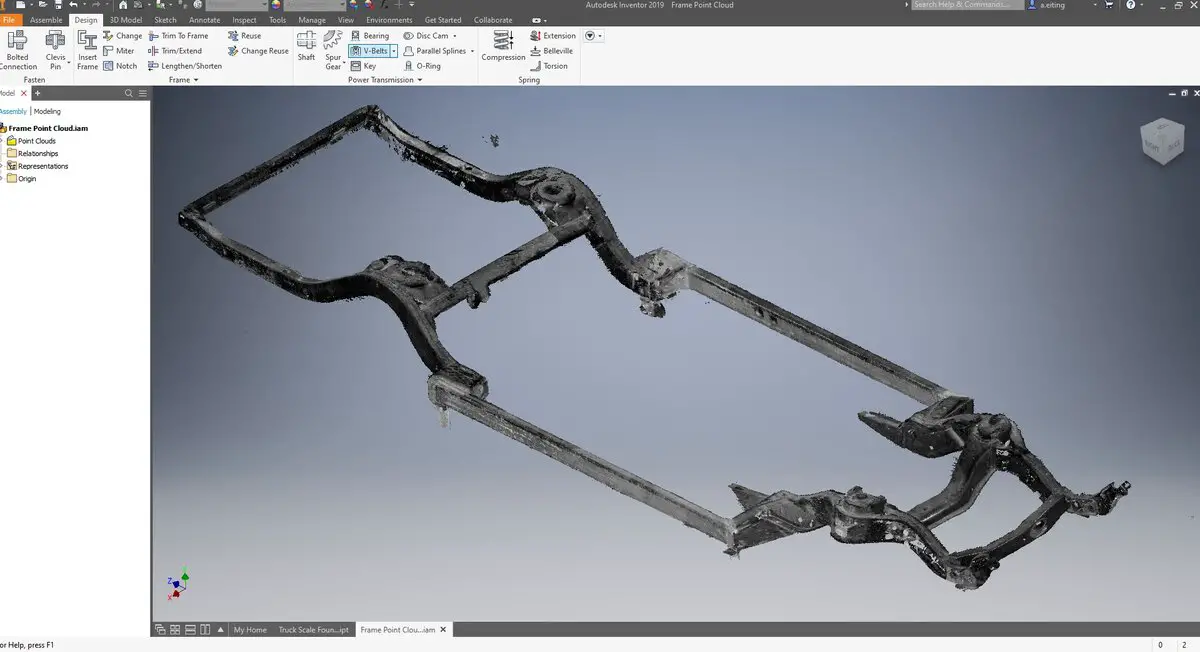

Now I can only work on this on the weekends or before work so it has taken some time to get everything processed and finally into inventor - but I did get the frame into inventor today!
So now I can do stuff like model up replacement parts of the frame - then see how it will fit with the existing frame and the body of the car. On top of all this - I had a wheel bearing go out in the Exploder and was up this evening replacing both of them so I don't loose a tire on it like I did on the Junker.
