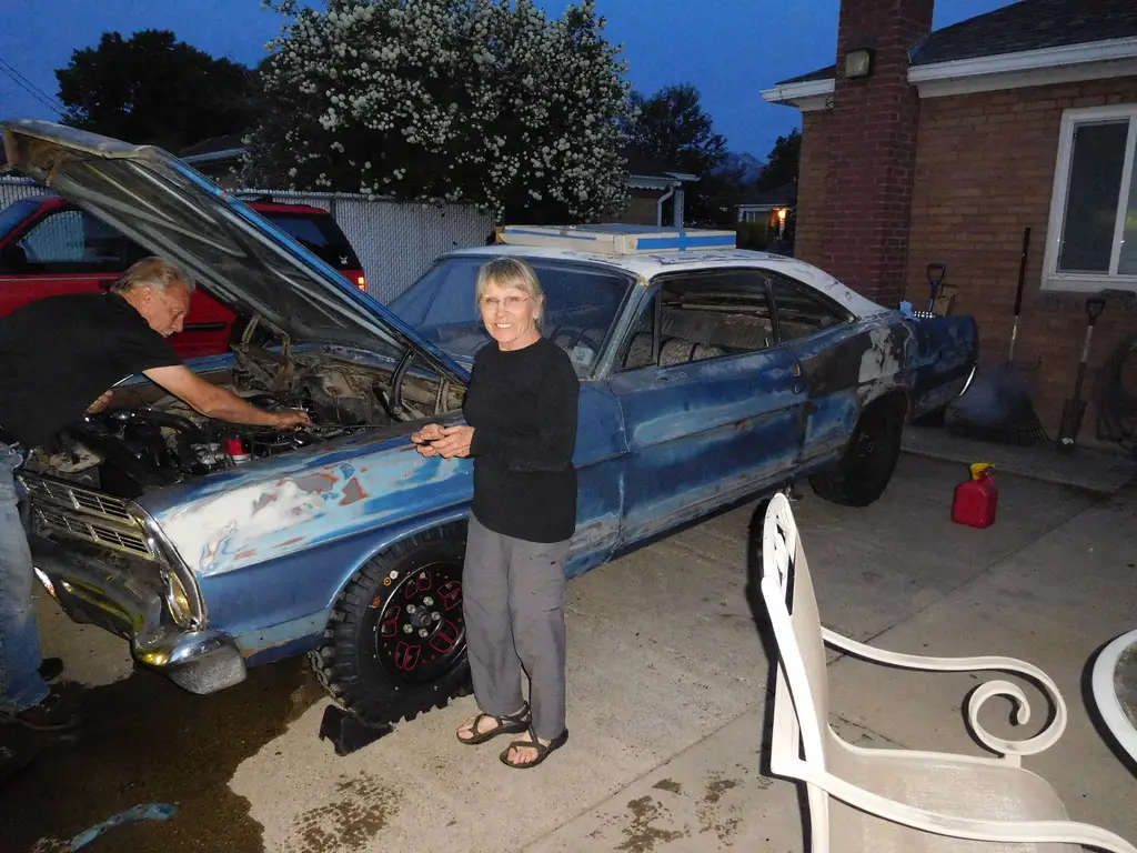

Dave and Gale approve :) Who knows, maybe by some unforeseen force this junker will have a shot at making it to Moab

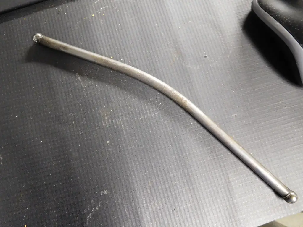

Well, here is where we are at. I bent a pushrod.
Went to drive it, saw the neighbors next door. They liked it and I figured I'd rev it for them. Gave it a decent rev, nothing more than we'd been doing about every day to clear the smoke out of the tail pipes. Sounded freakin awesome! Then sounded like ****! Went to the parts store, got a new one, was good to go. Took it on the freeway at 65, found it runs pretty rich. Smoked out the freeway pretty good at a higher RPM. Breaks are still a little so-so, we messed up the oil pan gasket when we dropped the oil pump drive shaft, still need to replace it. And we need some smaller jets in the carb to bring the timing down. With the cam and higher CFM carb it is just too much gas and too little oxygen.

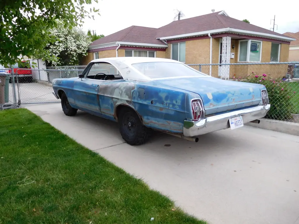

Hey guys! Sorry for not updating this as religiously as I had been! I've got her running ok, still burns a little oil. I've narrowed it down to being valve guides on the driverside head. I picked up a pair off of the local listings for $125 and they need some machine work. I'm planning on getting them all cleaned up and getting them machined so I can just swap the leaky ones off and put the new set on. I did consider aluminum heads, but they wanted $1890!!! I only paid $1000 for the car so we are sticking with the cast iron... Here is a pic I took yesterday of the beast!
