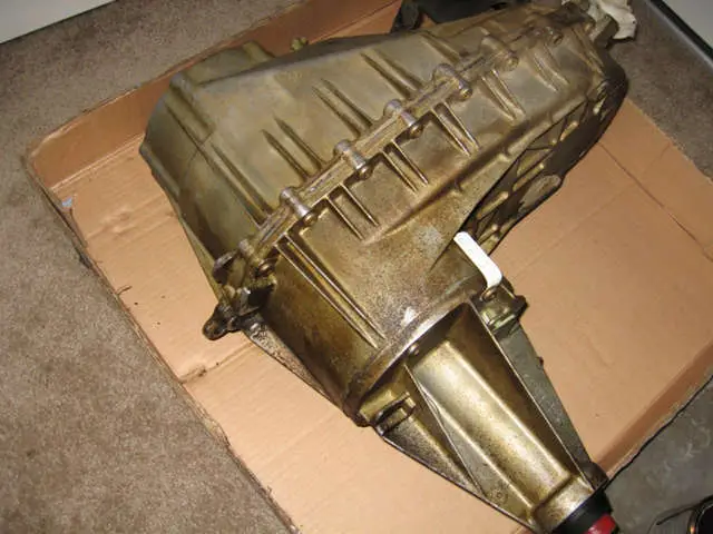

Well after reading all the threads on the AWD to 4x4 BW4406 transfer case swaps, I decided that this would be an excellent way for me to not only save in gas mileage but to enjoy the extra power. There is no need for constant AWD where I live. Here in Portland we maybe get a couple of days to a week of snow in a year, if that. When we do, that's when the 4 wheel drive will come in handy, otherwise we get ALOT of rain...2 wheel drive makes more sense period.
Anyways, I'm slowly buying my parts for the swap and I just picked up my manual BW4406 TC today. It came out of a 99' Ford F-150 and only has 17K on it, part number: manual shift, ID XL34-7A195-AC. It needs some cleaning otherwise everything looks pretty good. Here are some pictures:
