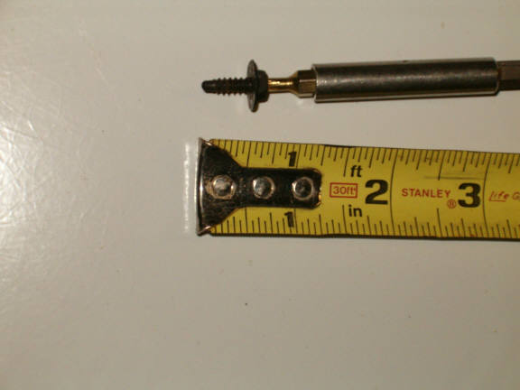

Also, could anybody let me know which screws hold the console lid down. I think I reassembled mine wrong cause the lid is very loose. A picture would be awesome if anybody could get one. Thanks!
Tell you what-
I'll take one out and get a picture right now-if you'll measure the front to rear throw distance-at the floor, of the shift lever. I don't have mine yet, and want a boot which will cover the hole--
:D
Deal. I can get that to you tomorrow if that's okay? Gotta study tonight and my truck is parked over a mile away from the dorm.
The throw is 2" or 2.5" front to back at floor level-
Keep in mind it has to come outward (sideways) from the 4hi to N to 4lo shift- probably about the same distance.
Thanks:thumbsup:
