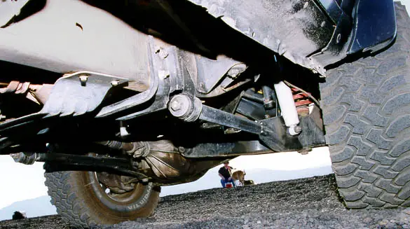

I wish I had more current photos of my radius arms. They have changed a lot since the above photo was taken.
The design above, bent upon impact with a boulder so they were reinforced. A second tube of smaller diameter was run below the main tube with about a 2" gap between them. Sheet steel was them welded along the entire length of the gap. Large holes were drlled through the sheet to help lighten it up.
The reworked design has held up very well for the past several years. They have taken numerous hits and have been dragged across some big boulders as evidenced by the gouges in the lower tubes. None of this abuse has bent them...yet.
The arms utilize the front of the stock radius arm brackets as can be seen in the photo.
I'll try to get a new photo online.
