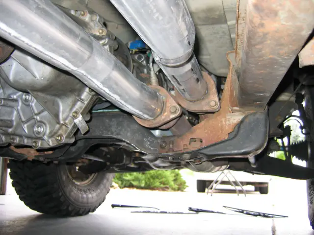

the 95-01 V8's also had two smaller pipes leading into the secondary cat converters and into the muffler, with a single pipe exiting
So I used a dual 2.5" inlet / single 3" outlet muffler on my trucks :) Flowpro mufflers can be run both directions...
here's my 96's 5.0L setup, done by Chuck, my exhaust friend:
Yesterday I started off with new exhaust thanks to my buddy Chuck at Discount Muffler in Denver:
First they hacked off the secondary cat converters:
Ran dual 2.5" pipes along the frame back the muffler hangers:
Flo Pro dual 2.5 inlet single 3" outlet
2.5" single pipe over the rear axle and out the side behind the pass rear:
Simple and it sounds MEAN, definatley picked up some low end with this single 2.5" pipe. I wanted a 3" but Chuck knows his stuff and suggested the 2.5", he was correct.
