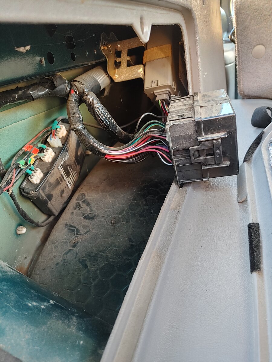

One other thing you might check...go to the back rear left access panel (where the jack is located) and wiggle the plug-ins at the RAP module. The locks on my '98 will occasionally act up and I just go back there and wiggle the connectors. Takes care of the problem until the next recurrence.

Can you tell me which one is the RAP module?
The brownish thing or the black one? (The small black on the left is the controller for the parking sensors...)
Thanks :)

The brown unit is it - RAP module.... on a side note there's a sticker on the face of it with your drivers door access code, assuming the previous owner didn't pass that on to you. Will come in handy if you accidentally lock your keys in the Explorer - I printed mine out on waterproof label and stuck on frame with magnets in case I forget it.
