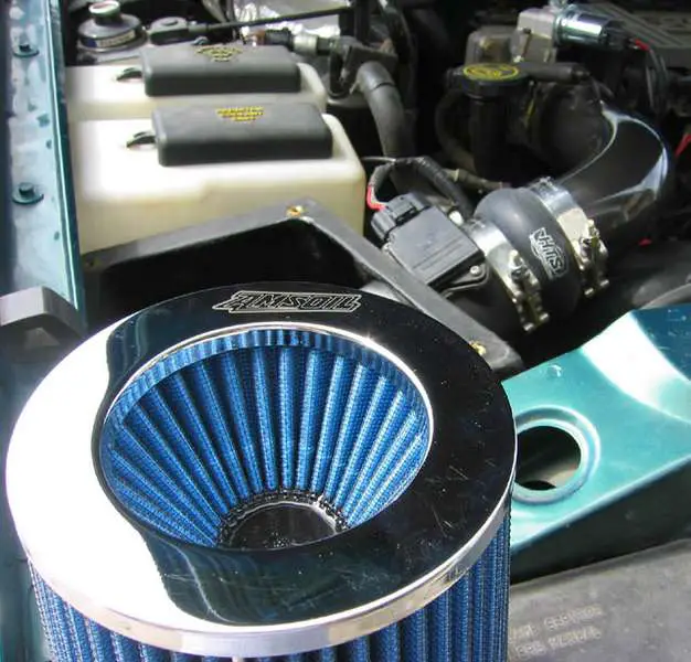

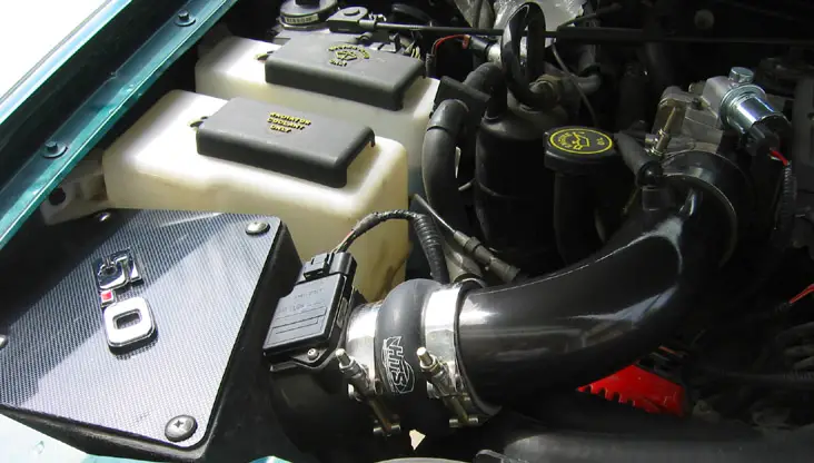

Here's some pics. It's a 73mm, an upgrade from 65mm. I did lots of research and this was THE part I wanted. I called Doug and straight up told him I wanted it, didn't ask opinions or anything, and he told me he's had reports of 5-7rwhp. I painted the grey C&L black to keep everything else in my engine bay looking "super stock" I also have modified my Volant box by cutting out the sides. It leaves the heat protection and the cool c/f cover, but draws in cool air from the headlights and fender. Like I said, I'll have dyno numbers this weekend hopefully. All I know is my butt dyno says it was worth the cost and that's good enough for me.

Your setup is VERY similar to mine. I painted mine a dark grey to tone down the stock drab silver it came in, and blend it in with the rest of my setup. :thumbsup:
