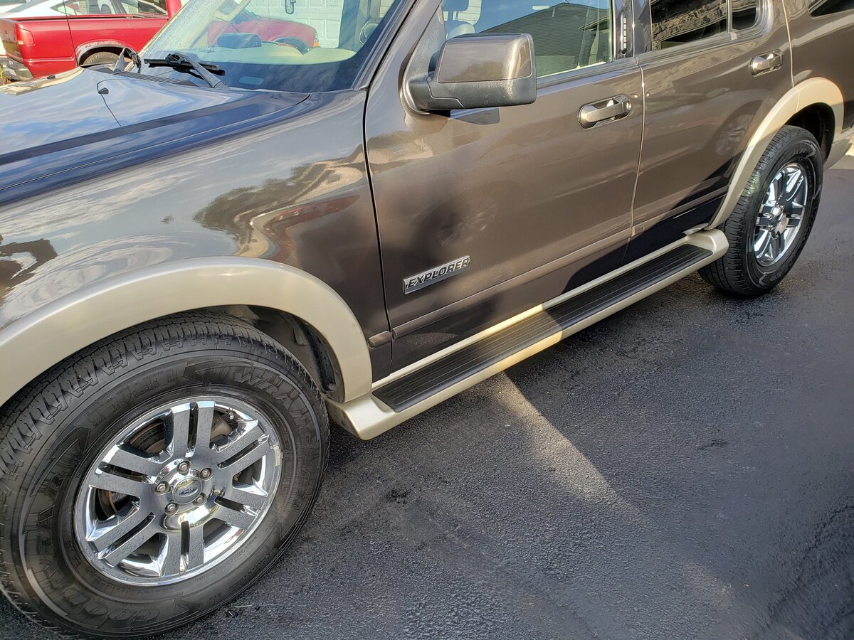

Wise guy-what tires did you specifically use? I'm looking for some that are a little more aggressive... Terra Grapplers, Wranglers, BFG all terrains on the stock 18's that markoesc has above in his pics.

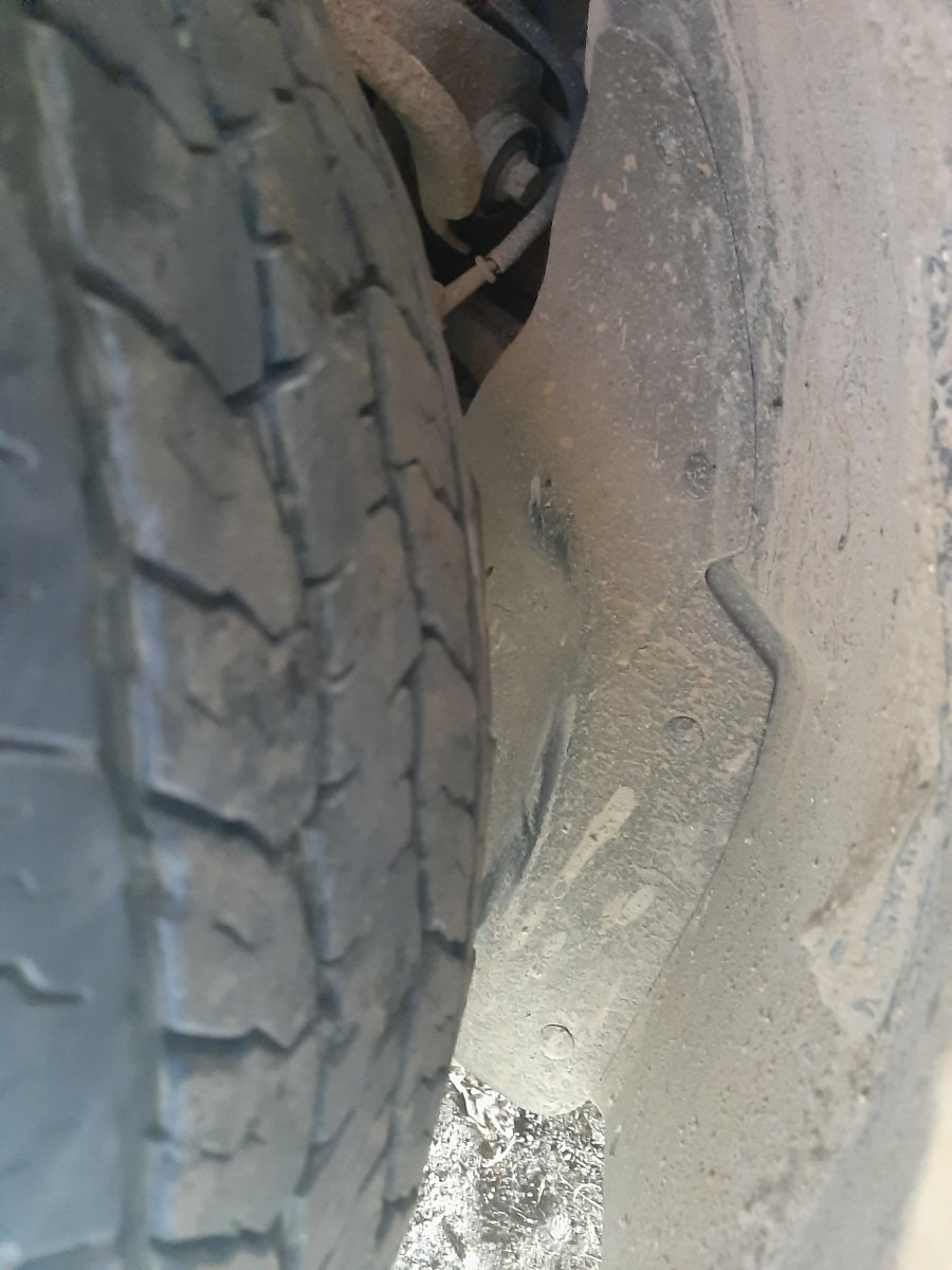

I've got Goodyear Trailmarks on my '06, 265/70/17. They rub a little in the back of the front wheel wells at full lock but it's inaudible, and minor to me. No lift, but my struts/shocks are due for replacement soon, so....

Sorry about the dirt, I do wash it occasionally, but live in the country so it never stays clean for long LOL.
