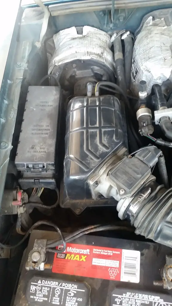

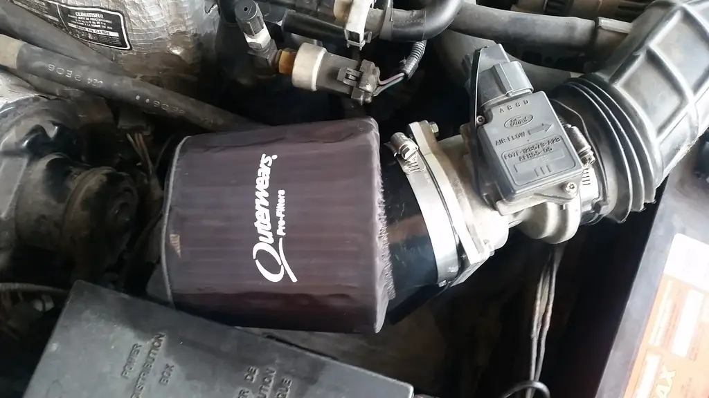

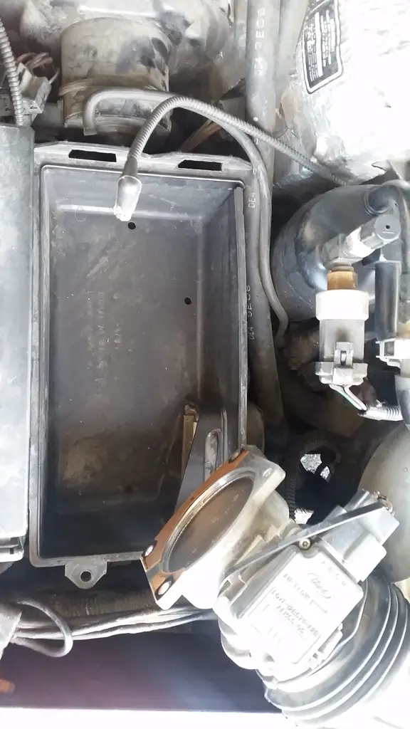

So as part of general maintenance I pulled off the air cleaner to clean the MAF and check the filter condition. Well the filter lid has two stripped out bolts and the tabs at the back are broken off. The cleaner lid to MAF gasket broke into pieces. So instead of trying to find another stock set up at a junkyard I ordered a KKM Tuning MAF adapter and filter and pre filter. I don't expect more hp, just a simpler to repair and service set up.

Installed the KKM tuning intake adapter and filter this weekend. The directions say to take out the extra intake tube that goes from the lower font of the truck to the bottom of the intake box but I didn't see a need for that as the tube doesn't move much and don't really see a need for removing it. Other than that it's perfectly straight forward and easy to do.
