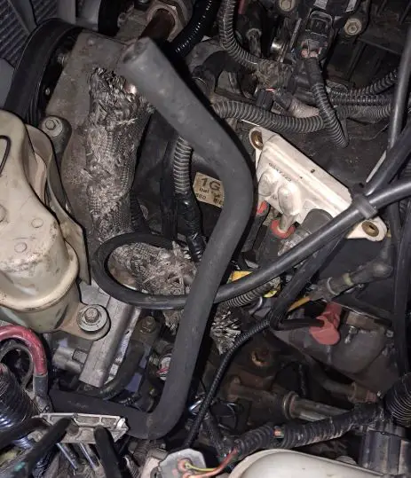

Missing a Hose Not Sure where it Runs to?
(See Pic) Highlighted in Circle Yellow

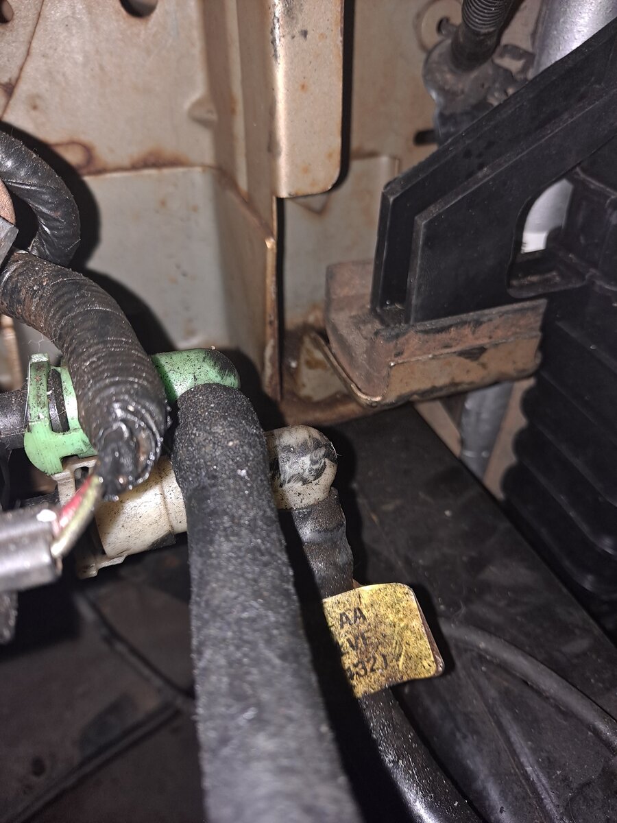

That's for the vacuum hose to the EvapPurgeSolenoidValve under the Battery tray;
on my 2001 connects to a green hose barb on the original Valve; other side of the Valve is a white hose barb.
@DILLARD000
Got It.. It was the only Hose not attached... but it wouldn't "Reach" until I Re-Routed it
That One.
Thank You

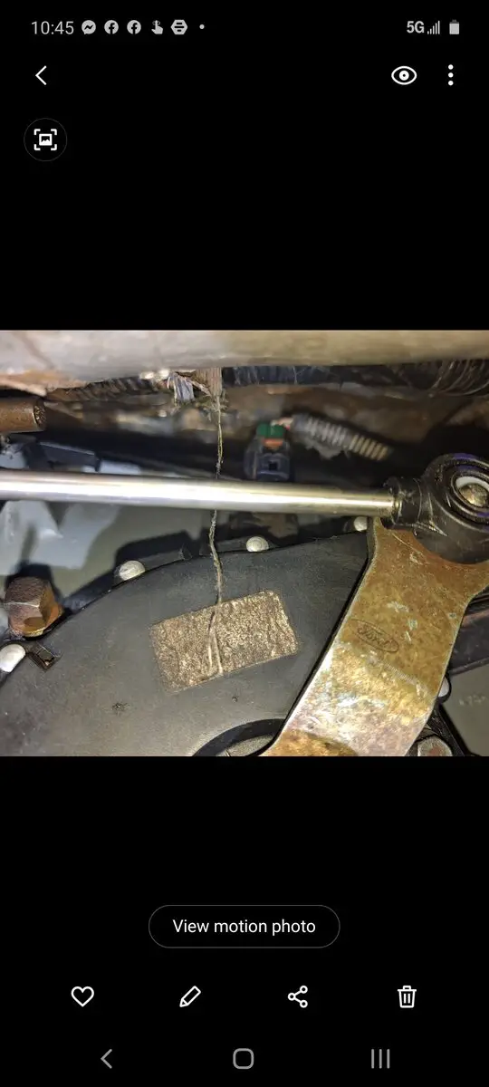

I did Break a Sensor at the Very Top of Transmission but forgot the name of it.
"I Think" its the "Female End" of the Speed Sensor ?
Don't have a Pic ..... If you need 1 I can get 1 tomorrow when the Sun is out.

Actually the Housing on the Speed Sensor and the Female Connector (not sure of name ) needs to be replaced
(See Pics) Sensor Greend Piece
Can That be replaced without dropping Transmission Again
