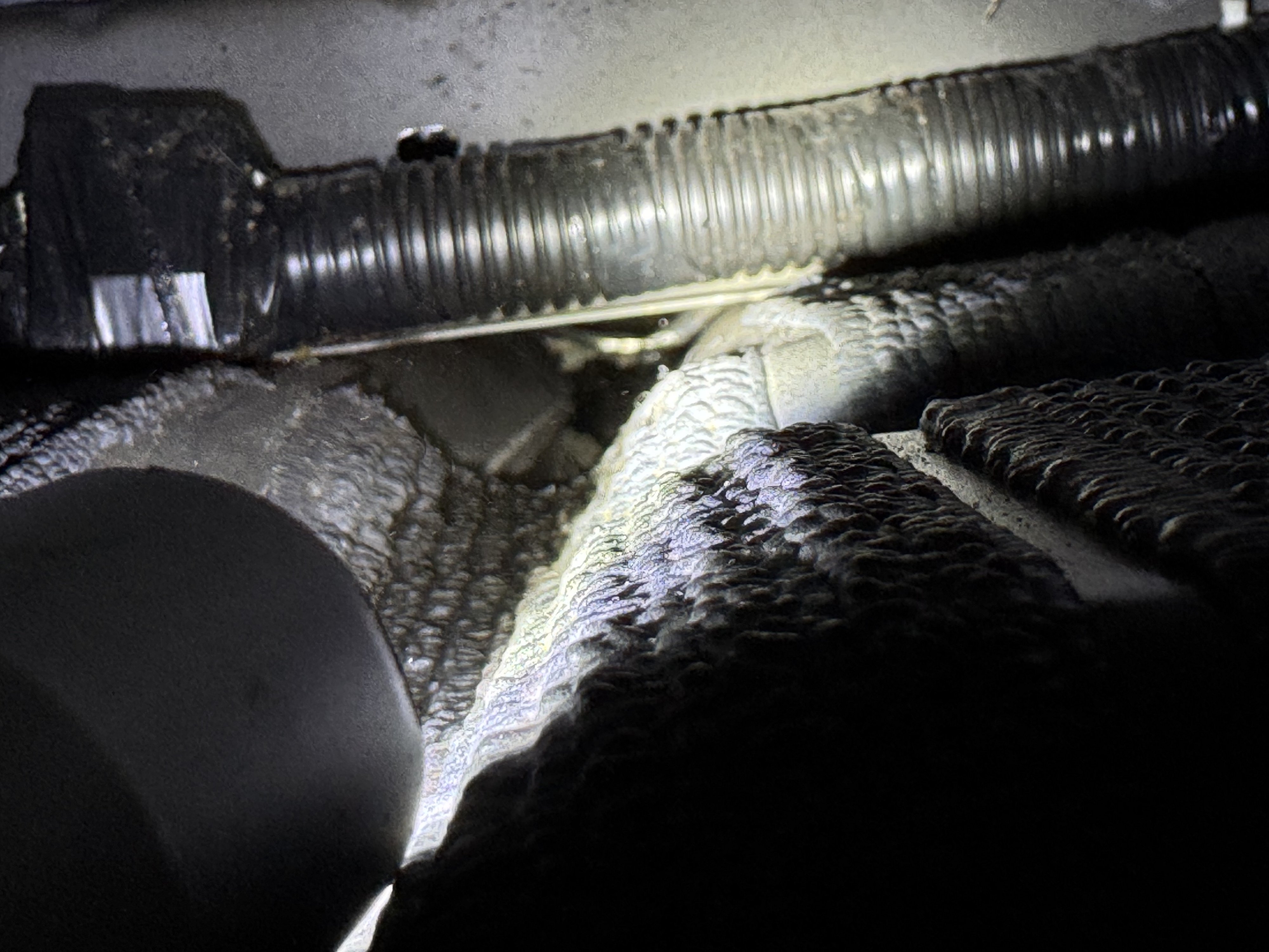

Went to a carwash earlier today, found a rubber plug on the floor is leaking slowly (1st photo, will ask the part number in another thread), and water leaking trace from the front row (2nd photo), only when the car starts moving. I don't have a clear under the seat so idk what that leads to, might update when I have a chance to remove the seats and take a look at it

But there is no PN for that body plug, and it's not available new. Just browse your local JYs if you can't simply pull that one out, clean it up, maybe add some sealant/adhesive, & put it back in.

Went to a carwash earlier today, found a rubber plug on the floor is leaking slowly (1st photo, will ask the part number in another thread), and water leaking trace from the front row (2nd photo), only when the car starts moving. I don't have a clear under the seat so idk what that leads to, might update when I have a chance to remove the seats and take a look at itView attachment 464108View attachment 464107
A quick update, I thought water comes from b pillar or floor, but actually front passenger side was completely socked. Eventually found out it was the clogged drain pocket (crawl drain restrictor?) completely filled with dirt, this YouTube video covered it
