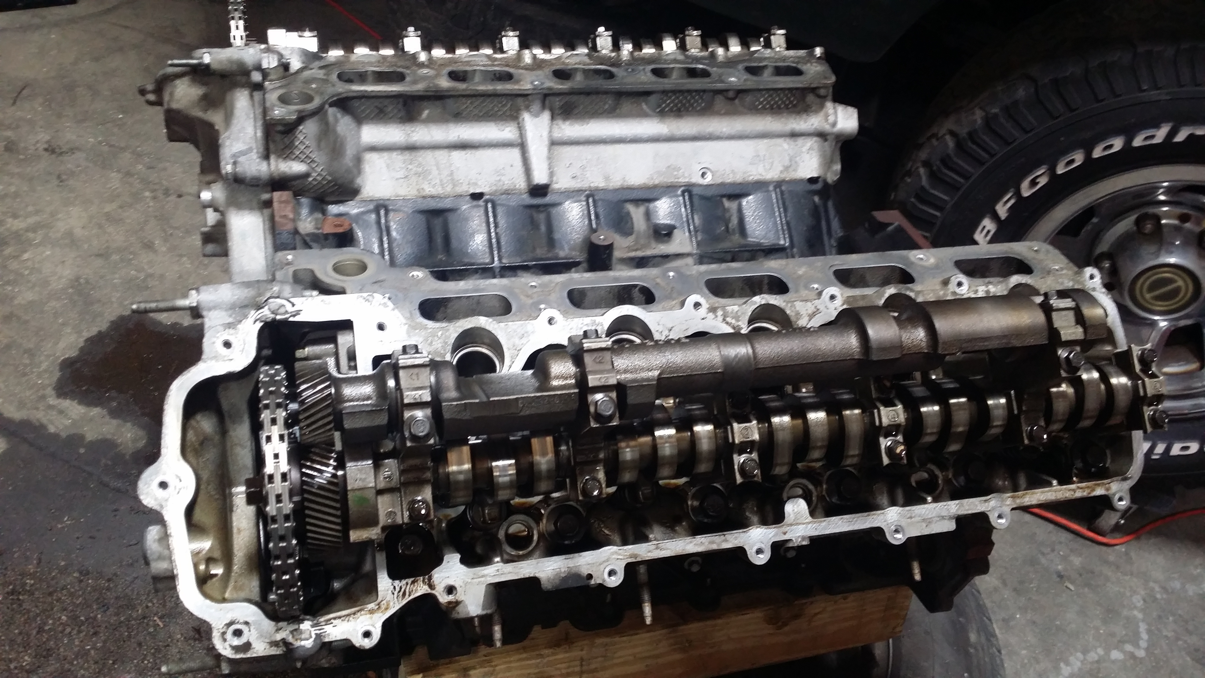

I've taken apart and repaired more ford engines then 99% of the people on this forum I'd say. The only things I will add to this thread is this:
Engineering has come a long way and the factory pistons/rods/bearings ect will run forever as long as they are kept wet with oil. I've taken plenty of sludged engines apart with 250k+ motors and have found great cylinder walls and tight bearing clearances as long as the motor was not ran dry on oil.
On the other hand your timing guides ABSOLUTELY HATE deteriorated oil with fuel contamination that starts at about 5000 miles with most oils (unless your always on long drives on the highway). Timing chains are what now ruins engines. Bearing, rod and piston issues are things of the past. Sure there are still some models plagued with certain valvetrain issues but I see many more timing chain issues in cars that have been "quick lube" maintained than people that are on top of their changes using a quality product and making sure the correct oil filter is installed.
FYI the local ford dealer here does free oil changes when you buy the car from them. But......... they use a $.79 filter on your car instead of a Motorcraft one with a check ball. Do your research and make sure your vehicle is getting what it should get and it won't let you down (hopefully).
Oh and if you want to know all my gasoline vehicles have Motorcraft filters on them and I use synthetic blend oil and change them every 3500-4500 miles. I also use 5w30 where it calls for 5w20. Everything I have has over 100k miles on it. My F250 gets changed every 3k miles but only goes about 5k miles a year, it gets basic Rotella T.
Oh and the thing of no synthetic from the start is straight from engine builders. The rings don't seat as well with full synthetic vs conventional/blend because of the size of the molecules lessening drag. Anyone that buys a new car doesn't have to worry about this as break in has already been done, it's the first 10 minutes of the engine running.

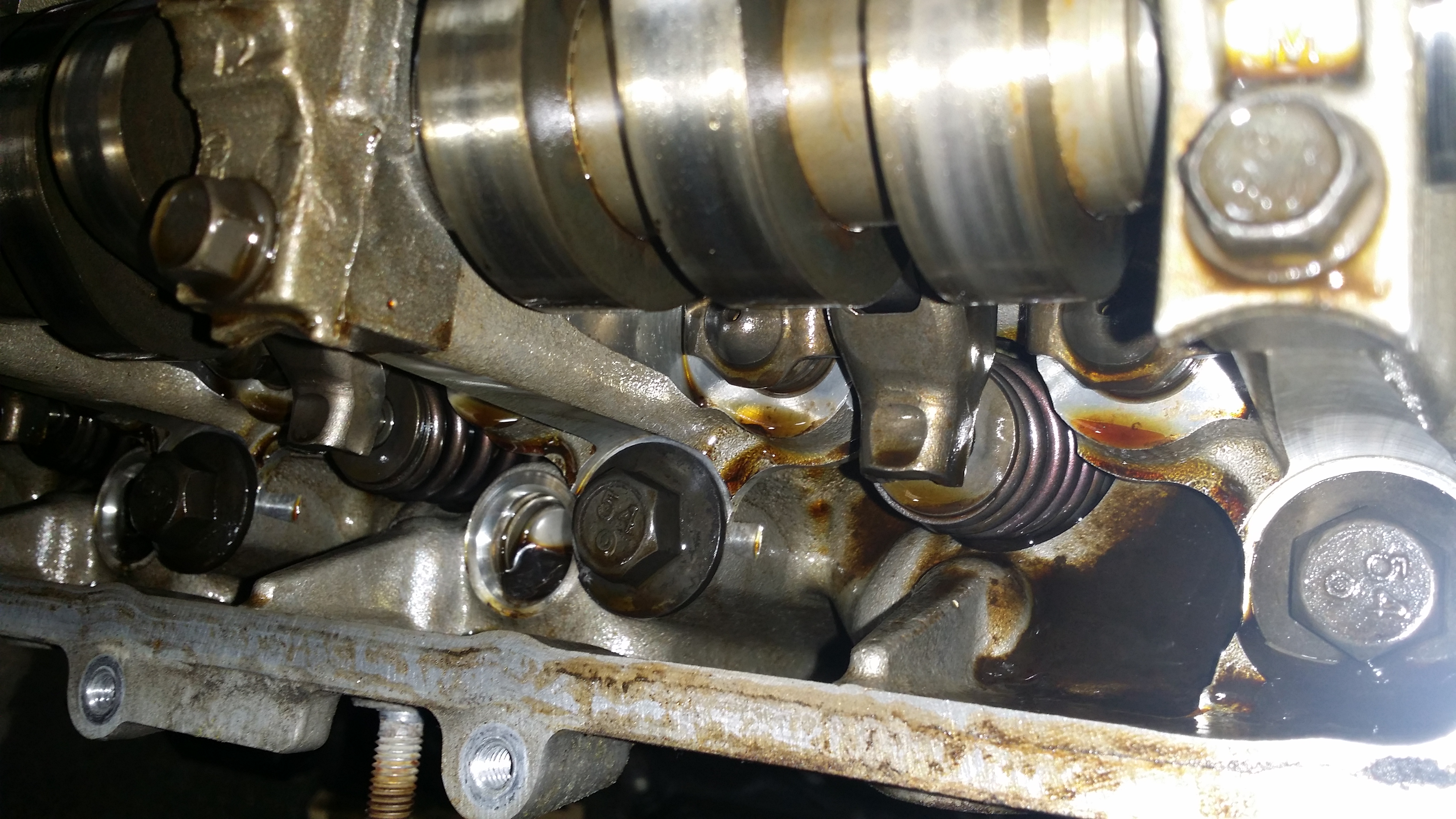

Here's a pic of the 86k 2016 v10 engine that has an entire log of his oil changes with 5k intervals. He only uses synthetic and is very particular. Since this is tow truck and it idles for 30 minutes sometimes I've suggested changing the oil at 3500 even with synthetic because the 5000 intervals arnt working. The right side is even dirtier but couldn't snap a good pic.
Most people don't consider their idle time. 1 idle hour = 33 driven miles.
