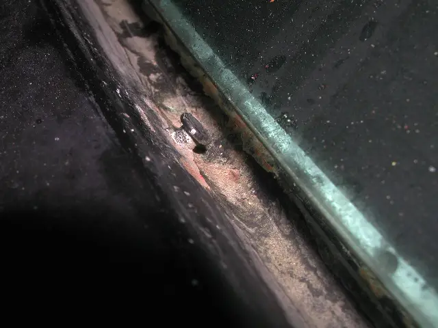

My windshield is cracked and I'm planning on having it replaced next Tuesday. Before they replace it I would like to remove my old windshield weekend so I can repair rust damage in the channel at the top of the window. So I'm looking for info on how to remove the thin black metal strips which are attached to the bottom part of the window.
I'll get you some pics tomorrow...showing how it attaches and detaches.
That would be very helpfull, Thanks!
This isn't great, but here are some photos of that area, with the molding removed - you ccan see the bottom of the glass, and the little post that the molding clips on... for now I have 2 pictures of this area (mine is rusty too and will be fixed prior to starting "My Explorer Painting Diary" this fall.) The molding pics will come tomorrow. Suffice it to say that the molding clips into these posts, which are spaced about a foot apart across the bottom.
