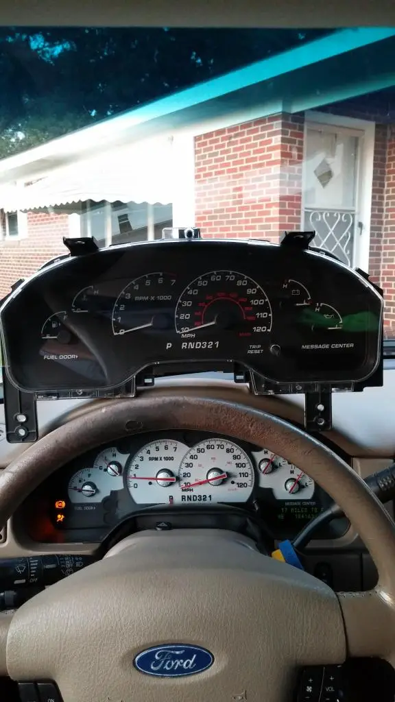

Did this swap yesterday I like the look of these gauges way better!

I have read this thread and several others and cannot seem to find an answer. I have an 02 X Eddie Bauer 4.6 4x4 w/ message center. Build date of 01/02. I bought a mountaineer cluster from an 02 w/ message center that says its good for the ones up to 03/02 so I should be good there and it should be a direct swap correct? Well I put it in this morning and everything was a straight forward swap, all the connectors were the same but I have nothing. It is completely dead. Fired up the X and nothing lights up or moves at all. So do I just have a dead cluster or is there a certain year one that I need? I dont want to do the hybrid way as I want to keep it all working as it should.
Did you swap out your message center board? You will have incorrect mileage if you dont. It's been a while since I did the swap when I had the 02 so maybe someone figured out how to reprogram it. I hooked up the mountaineer cluster to verify it really has 4x4 lights and instantly added 30,000 miles until I swapped out the boards
So new information. I found out that when you turn the left blinker on the high beam light flashes on the cluster. When you flash and hold the high beams on the left blinker light comes on in the cluster. Nothing happens when you turn on right blinker. However my front right corner light is illuminated all by itself with nothing on. Unplugged cluster and light went out.
As to the question about the message board, no I have not. I'll go do that tonight and see if that changes anything. But you just said you plugged yours in just to check the 4x4 light situation and everything worked?? Except for the fact that the mileage on the mounty had 30,000 more miles than yours. So mine should be working too, without having to swap the message center board. So either there is a step I'm missing or its defective. Or its from the wrong year and has a different pin layout. That's what it seems like. even though the plugs go right in. It's like the wires in the plug or cluster are hooked up wrong???
