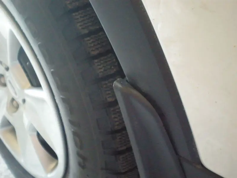

I just put my fronts on this weekend. They look good except there is a gap at the very top of them when looking along the side of the vehicle. They fit the contour well below this but I couldn't get this gap to close up at the top. Does anyone else have this?
I just installed the fronts this weekend. Fit is good but there is about an 1/8" gap at the top but they hug the contour of the plastic trim below that. Does anyone else have a gap at the top when looking along the side of the vehicle? I can't figure out how to close that up. Any recommendations?
I too had a gap.
Yup. Mine were dealer installed.

Thanks Peter for merging. So is this gap caused irregardless of dealer vs personal install and has anyone come up with a way to make this more snug or effectively close the gap ?
Thanks
That seems to be the case since the gap is there in both installation scenarios.
Thanks Peter for summarizing. I hope there may be a way to close the gap or, I don't know move the installation point to help but that may not be the case. Lastly can anyone comment if the instructions show drill bit size needed or not. If not can anyone share that info here in what bit size they use ?
