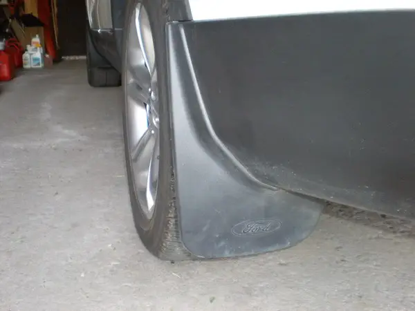

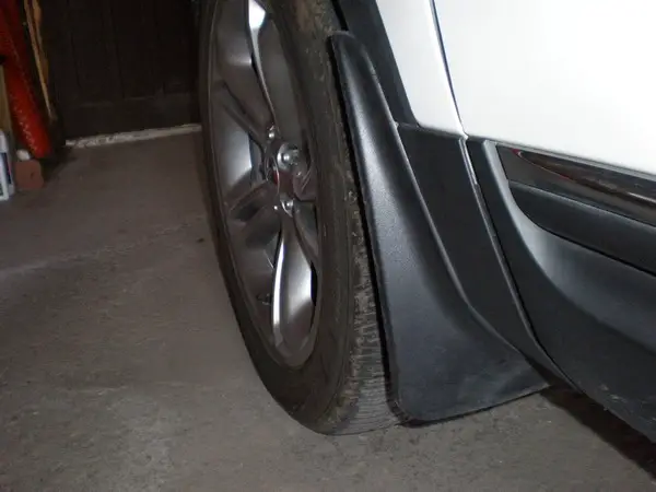

If you get the OEM ones they are the same for all models. Have attached pictures of mine and moved your thread to this existing on as per my PM.

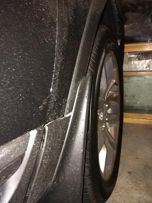

Installed mine yesterday. The rears were a cake walk; the front set was a pain in the arse. Ended up buying some automotive rivets from Lowes for the top of the front set and bottom of the front right flap which eventually broke from pushing on it because the parts you are supposed to reuse are not long enough.
For the top gap on the front I drilled a new hole and used 1/4 plastic screw rivets. Overall, I'm satisfied with the results.

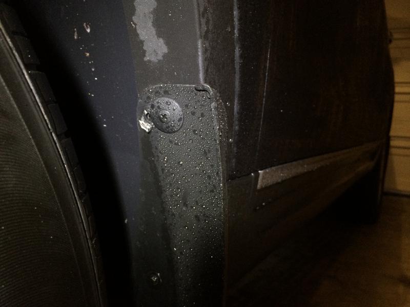

What did you use on the side for the fronts (the holes were the nylon fixers were before) at the part where it attaches to the side of the existing plastic trim and has a screw track rather than hole ?
I couldn't find anything long enough at parts stores that would fit so I used a screw in the end for now but not overly happy on that idea. Any suggestions would be great. Will also try and post a pic

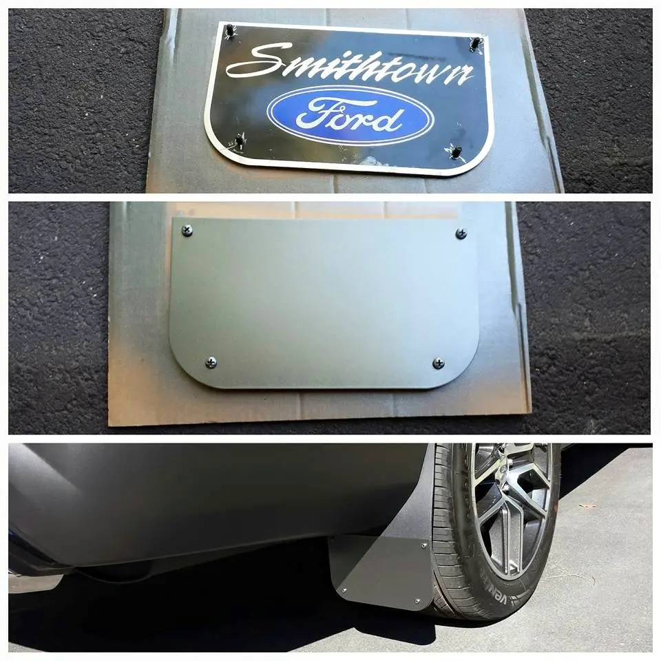

Made these from the ones the dealer installed and they work great at keeping mud and road grime off the rear. Grinded off the rivets to separate the aluminium plate, sanded, painted and then clear coated. Reinstalled plate with small plastic bolts and then reinstalled on Ford with original screws. small can of paint and clear coat $15 and screws $2.50.
