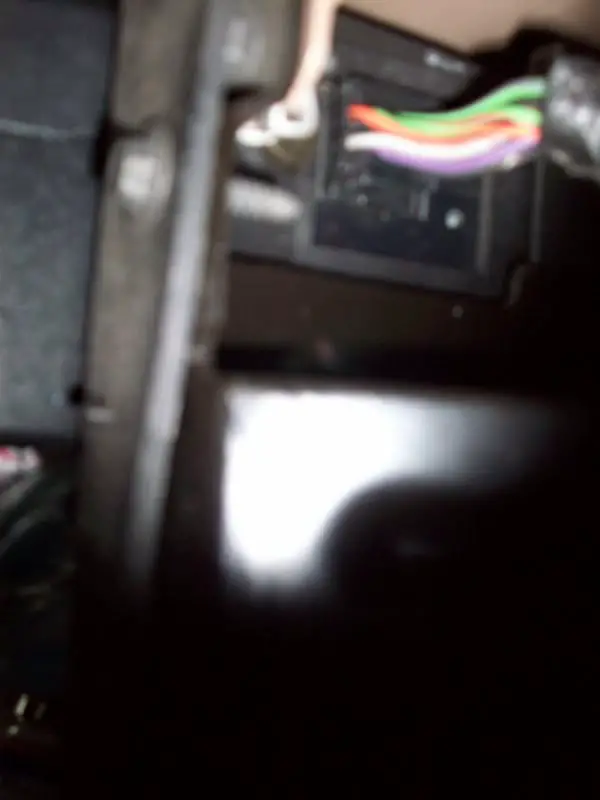

and the wire harness visible when you remove the tissue holder/cup holder assembly:
once you remove the 4 screws and wiring you can pull the liner out of the console and there are 3 set screws holding the changer to the liner. hope this helps!
