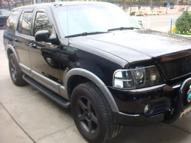

heres a pic of one of the rims..not that great but i just wanted to show you guys how they came out.. i have no time to mount the tires so it might take a while for better pics

I think that looks great:thumbsup:

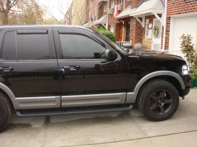

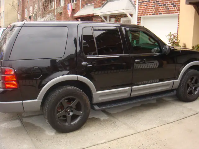

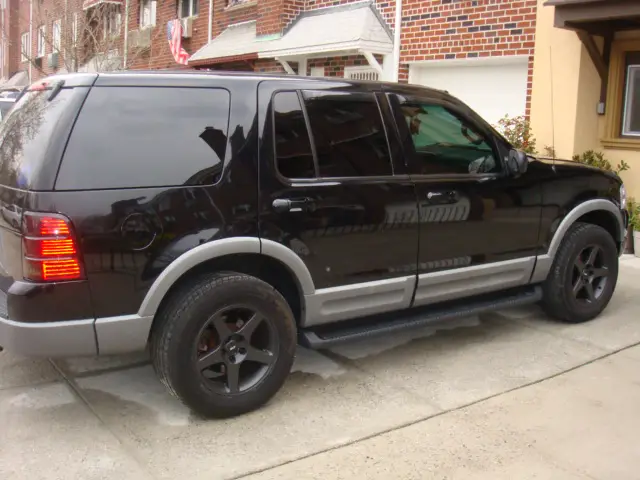

i figured ill post some pics of my ex with the svt rims in this thread also...

I'm gonna get a set of these for the wife exp
Sweet... I ALMOST went with those myself. Make sure to post pics when you get them! Have fun
