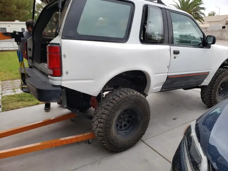

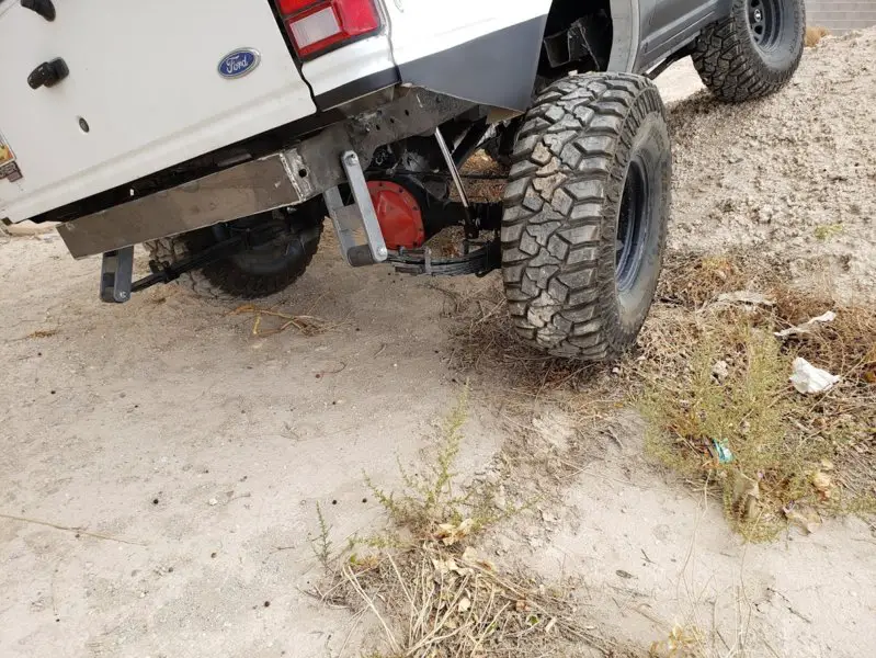

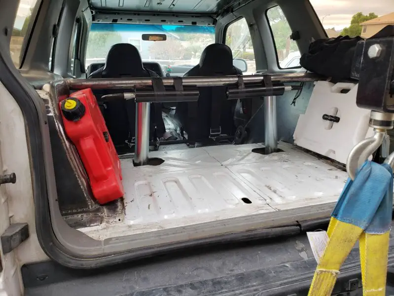

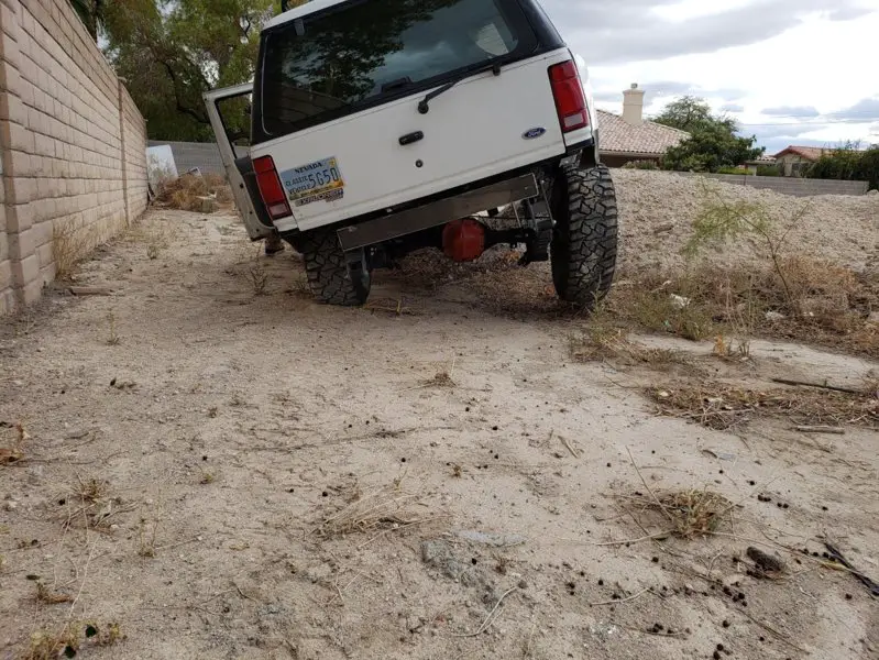

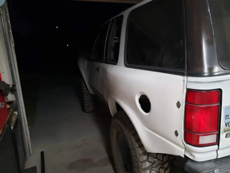

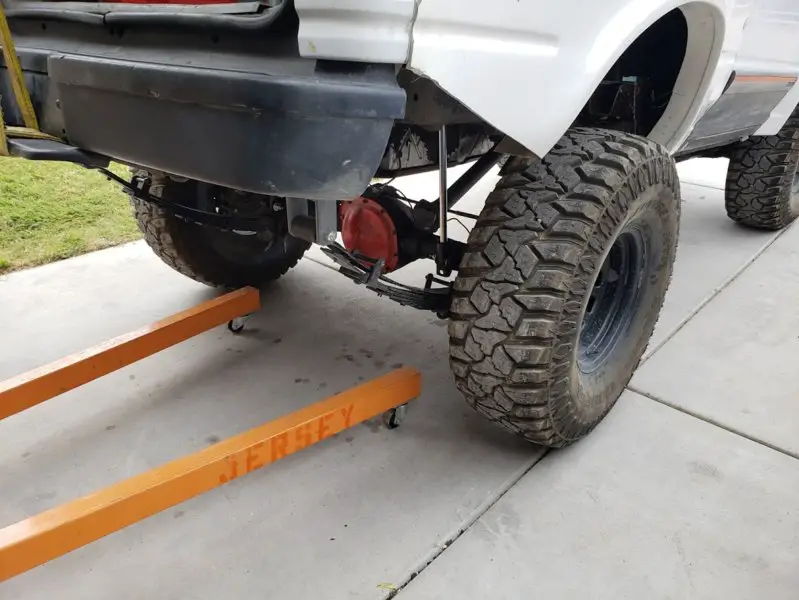

real mounts for cans will be on this week. Stopped at little dirt lot near house to check rear flex. And got new fuel fill line in and attached to fiberglass.

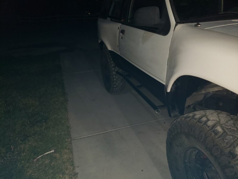

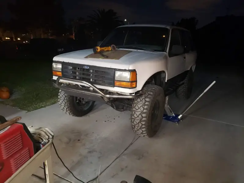

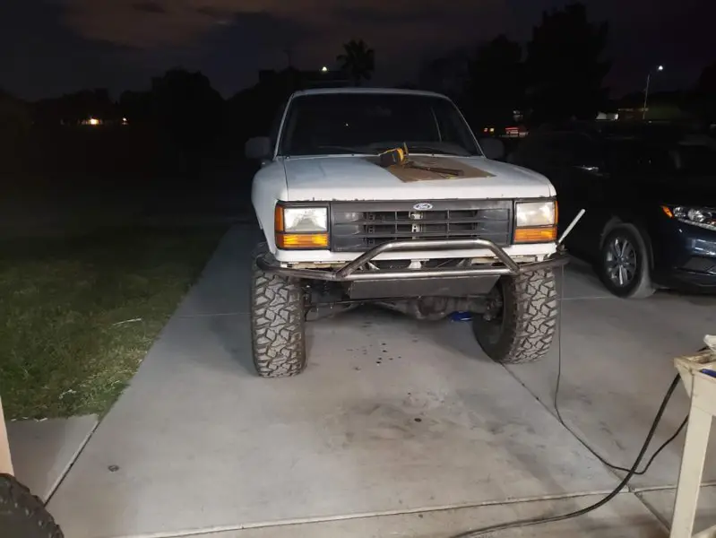

not the best pics, I dont know why my camera on phone wasnt happy last night but here is the rock sliders started and front bumper close to getting done.

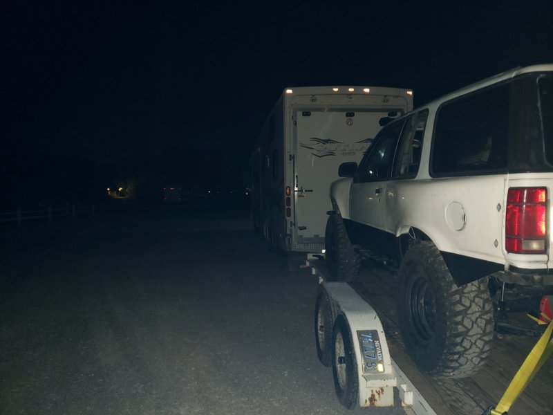

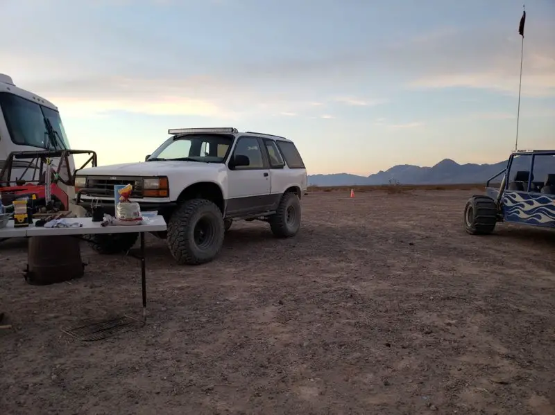

Made it through the weekend out at Amargosa sand dunes and tried to find the crawling spots into death valley with no luck.
Ex played good in dunes and in desert overall. I will be ordering up coil overs for front this week. Rear suspension is outdoing front by a lot now.
Did get some video and will post up later today.
