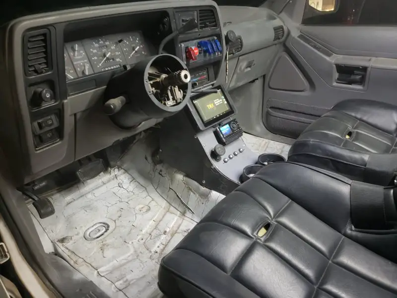

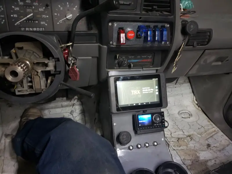

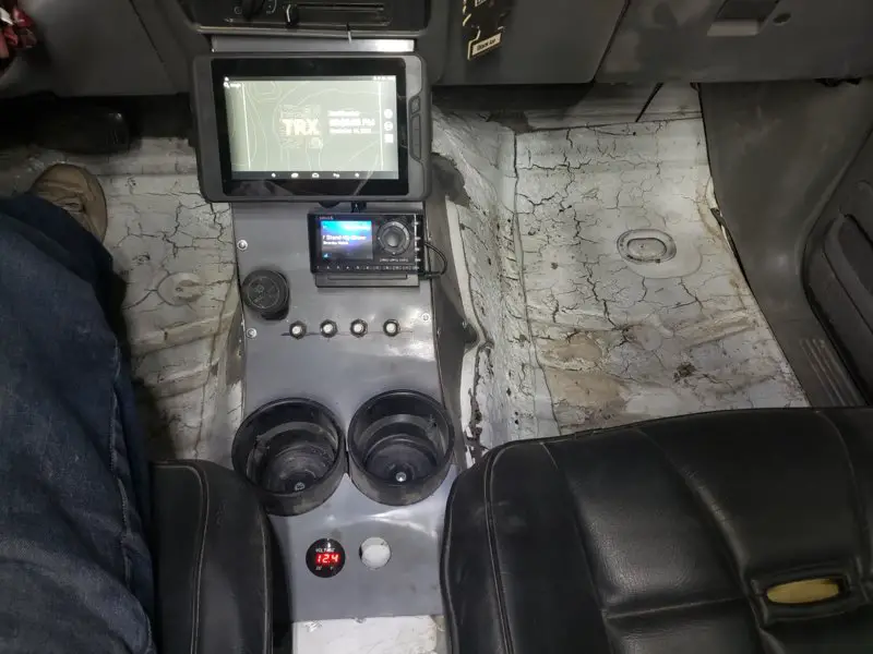

Center console coming together

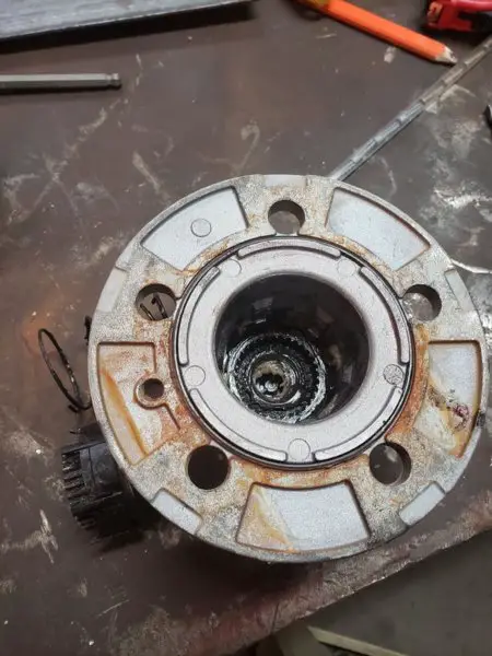

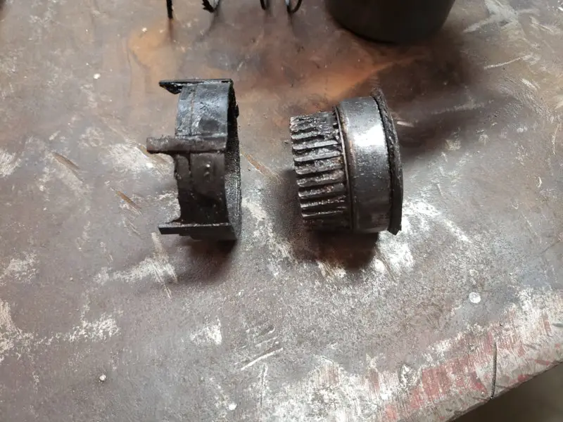

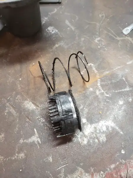

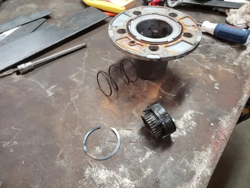

Has anyone else had problems with the warn manual hubs?
Had passenger side break this weekend.
@R.J. used to blow them all the time.
Is there an option to just fully lock and delete all hubs completely?
This is just a play truck and not a daily driver so an always locked option would work for me.
There is a set of hubs that Warn makes that are stronger then the ones they will sell you for the TTB
Let me do some digging, it has been a while. They were made for a rear axle kit for a jeep, yes hubs on a rear axle. But they fit our D35 ttb and are stronger
You want the hub to blow before the U joint and axleshaft, so its not a terrible thing to blow hubs.
I have not seen drive flanges for the D35 ttb, this would be the part that eliminates the hubs, not sure if anyone makes them for us
Those hubs look pretty dirty and packed with grease?
They should be clean and only lightly coated with lubricant
