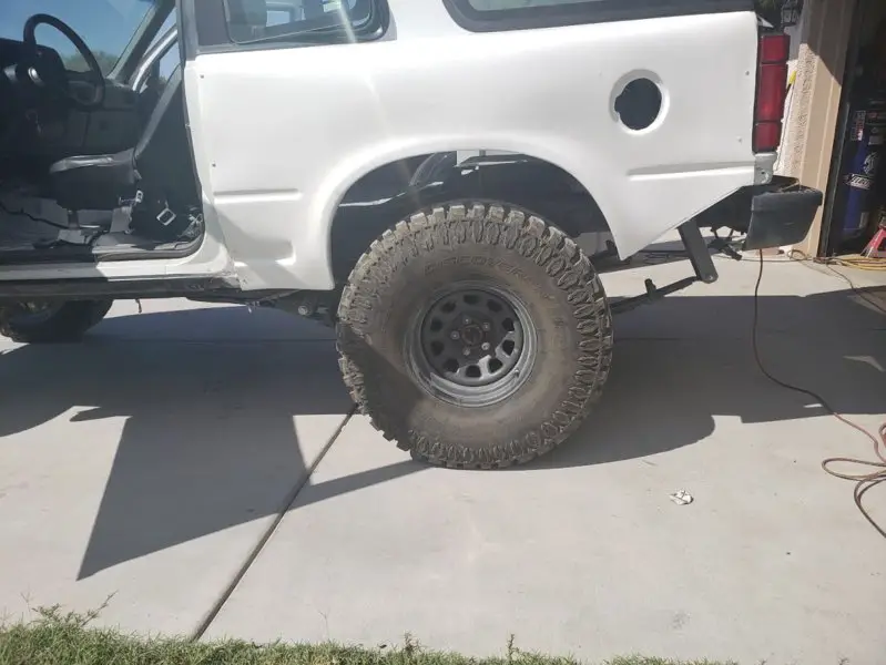

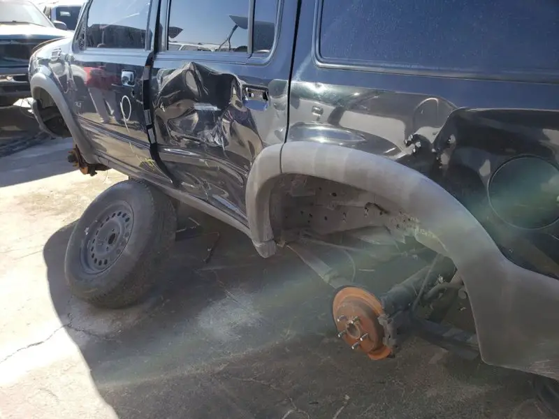

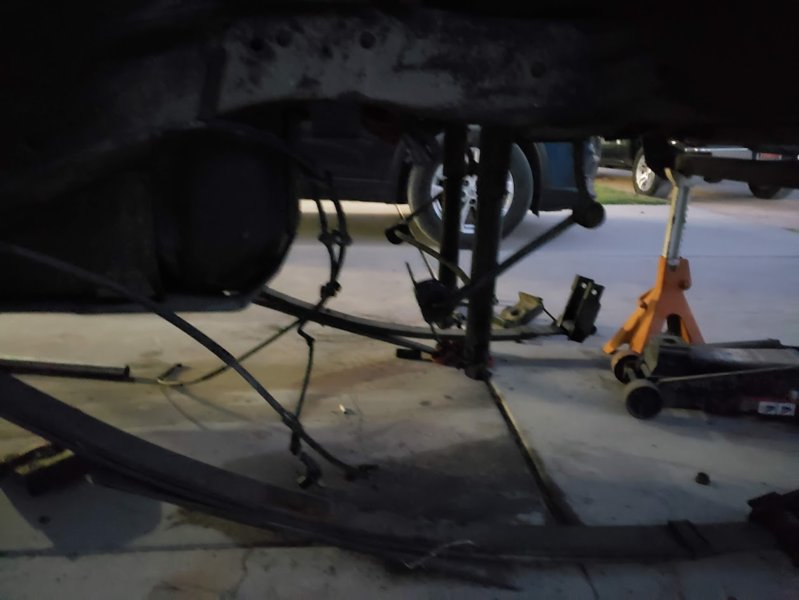

Sunday morning trip to pic a part and take complete rear axle from this 2000 ex.
Got axle pulled and gears and locker are installed. Did pick up parts to convert brake lines and emergency brake over to tie into 92.

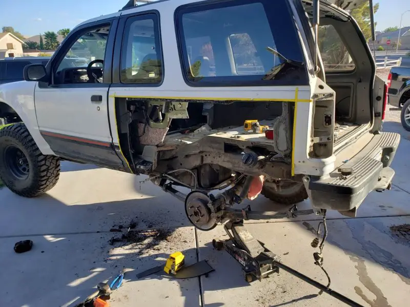

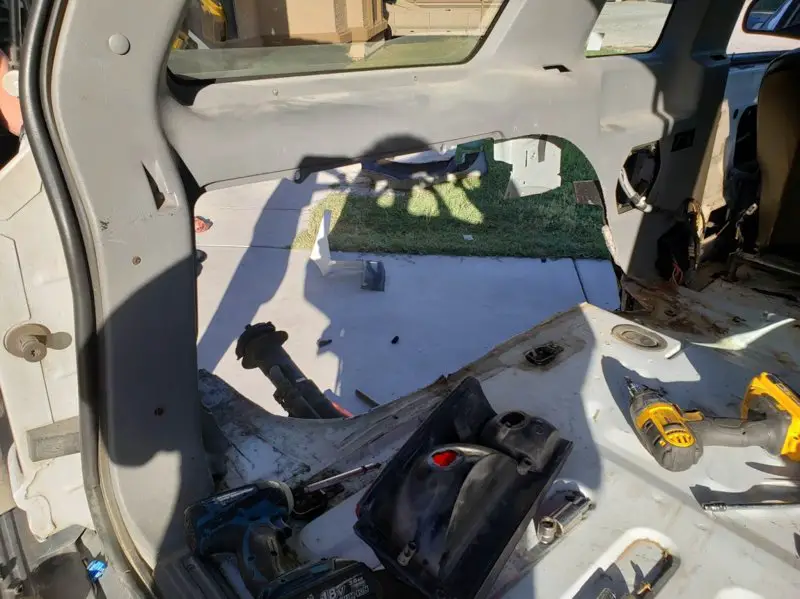

Looking good ! I would be tempted to use clear RTV and some broadhead "Marson" rivets for the QP install in case it needed changed quickly.
Marson | Rivets
Keep it up ! You're moving along quickly !
